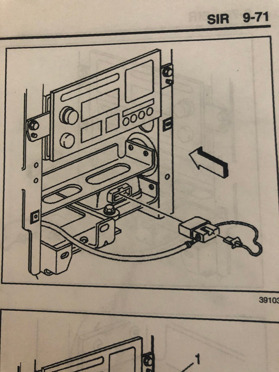

Thanks, trying to figure out how to do that without tearing half the car apart to get to the SDM. Service Manual is not super-clear on location of the connectors outside the console where the SDM lives. I'll continue to study the SM and find a good spot for a power and ground check. Car is rarely driven so I'm not in a rush.

Looks like you’ll just have to remove the Accessory Trim Plate and the HVAC control head...should be below the HVAC...connector is in the front !!...it’s best to check power and ground at the module itself....do you have any U” codes (communication codes) present ??

FINAL POST - After a lot of fooling around with grounds, power supply and checking connectors with no faults I became convinced the problem was the SDM itself. I found a replacement with the identical part and service number. I installed it and the computer picked it up right away. the light is out and all is well. I really suspected the SDM right out of the bat but was reluctant to change it because of the need to re-program, Found out that the VIN is not in the SDM, What is checked in the state of health test that it does when the car is turned on is to look for the last 4 digits of the part number. If it's the same communication is established. So my problem is fixed without any costly outside "help".
