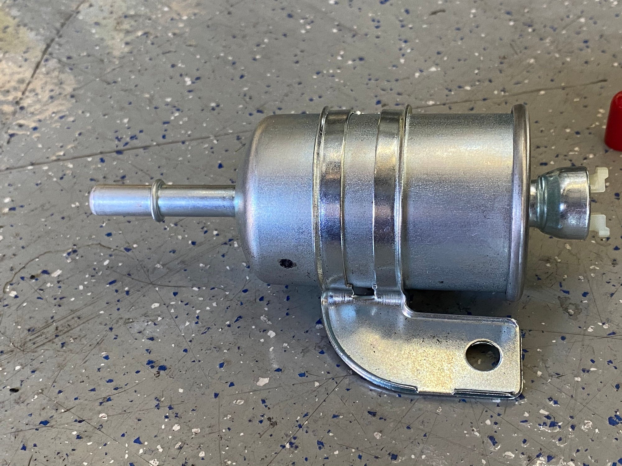

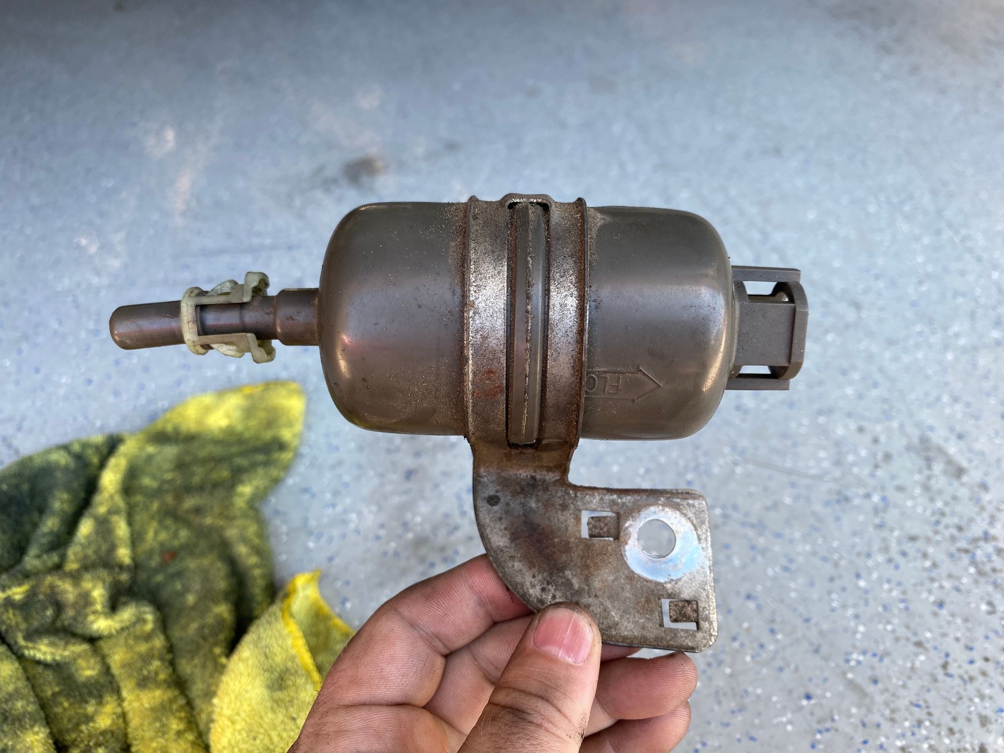

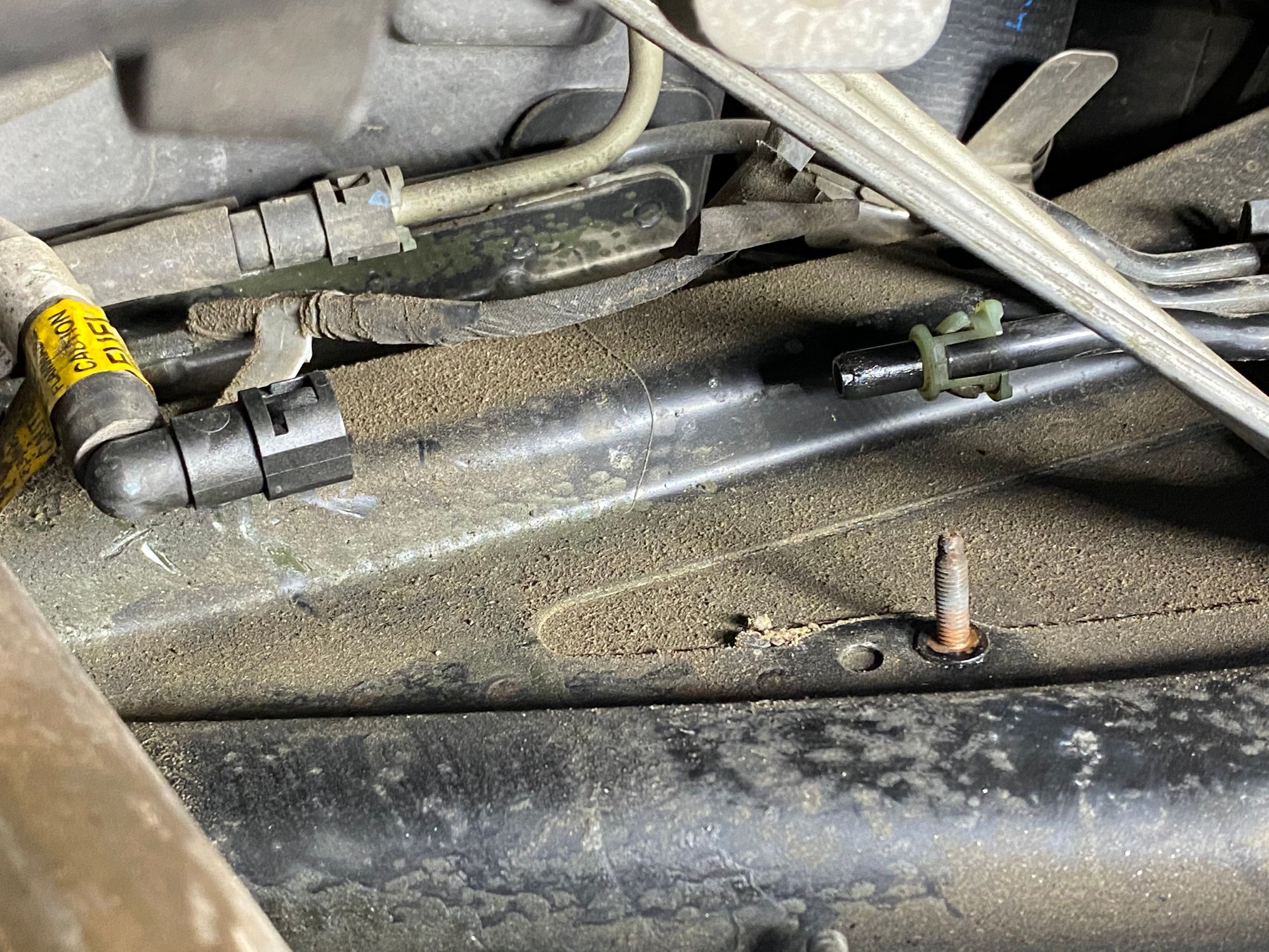

So I was going to remove the old filter and it took the strength of Hercules to remove the lines. The problem is, I think the plastic clips came off the wrong ends.
As you can see from the photos, the inlet side clip stayed on the filter and the outlet side stayed on the line. the new filter is the opposite (has a new clip on the outlet side).

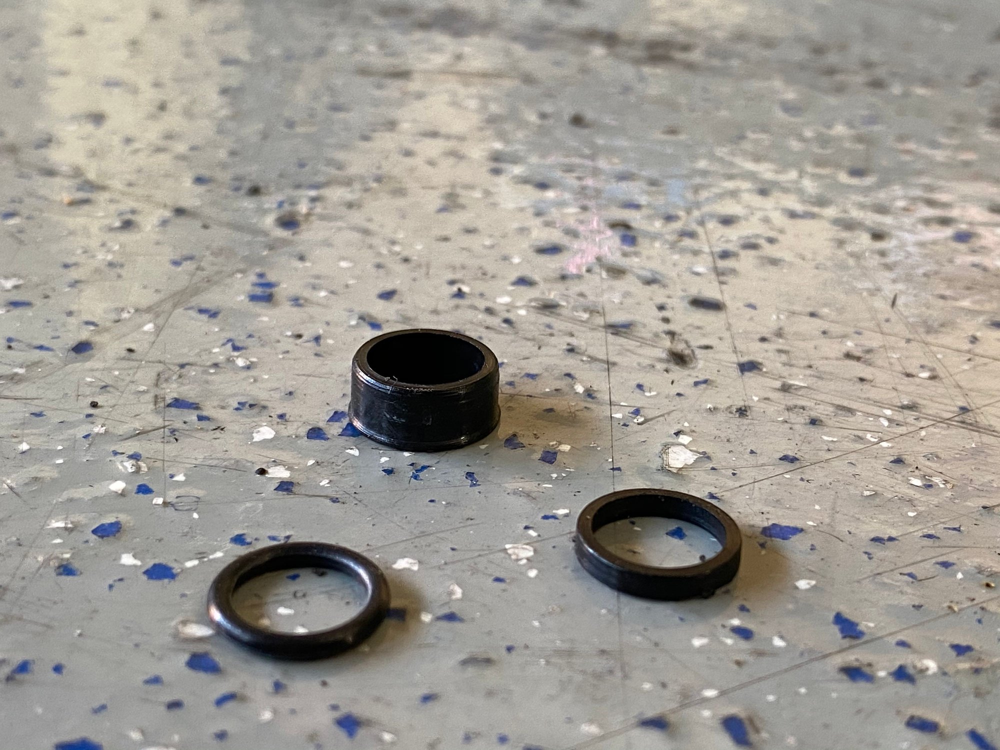

I also had some plastic and rubber o-rings fall out of God knows where in the process. I believe the large one came from the out side and the other 2 from the in side.
can anyone set me straight on how to proceed?

on the clips, you have to pry up on them from the bottom (the area circled from the picture you posted) and that will release them from the ridge on the line and they will slide right off... to install the new ones just press them on and they will snap in place... the other stuff that fell out I'm not so sure of lol

Looks like the right filter to me. Pretty standard fittings for fuel lines.
