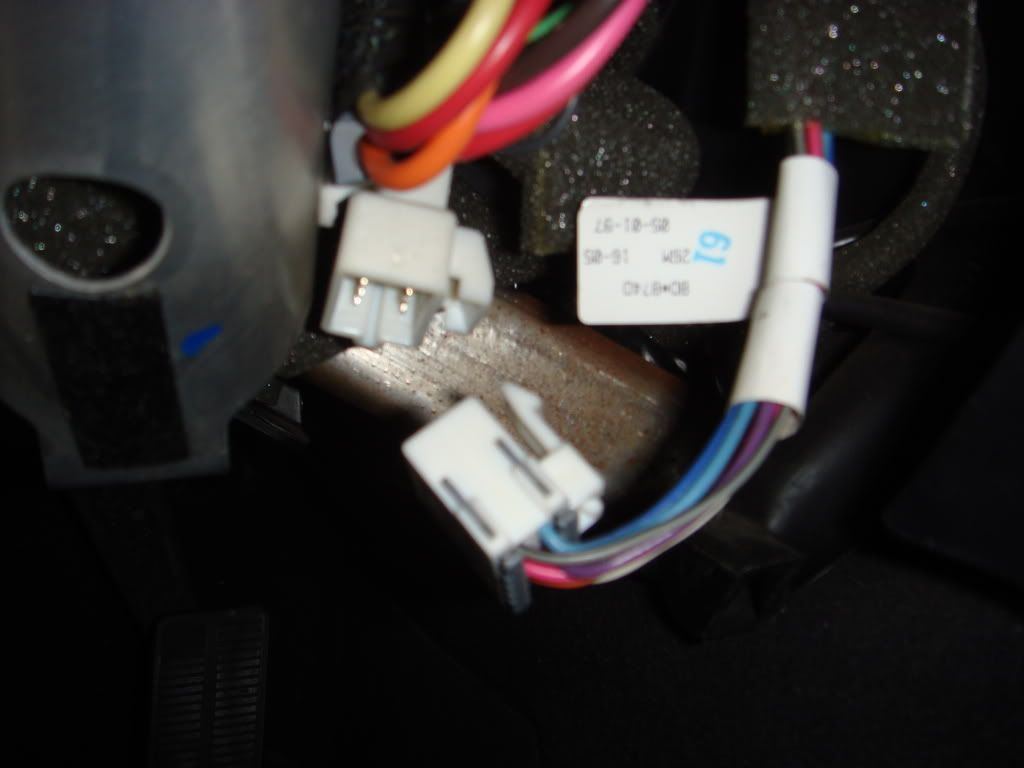

​​​​​​​It's fast and simple. You just need to remove the driver's knee bolster to have better access. The connectors you need to separate from each other, in order to insert the hyperflash harness in-between, are right there by the steering column.
Connectors should be directly below the ignition key switch:
