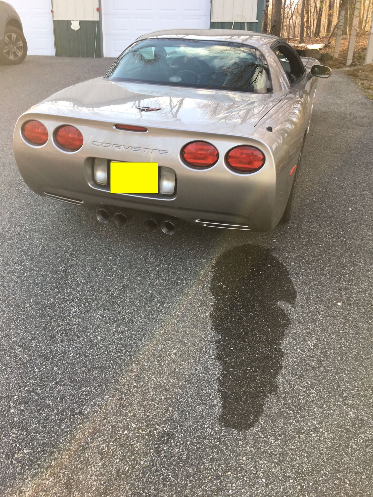

Went for spirited drive, visited a friend (I know, flouting social distancing rules, what can I say, I'm a rebel). When I went to leave I was greeted with this:
Suppressing the urge to vomit, I got down near the source of the leak as it was still dripping. I put my hand out underneath and was delighted to feel that it wasn't oil. It was clear, had no odor so... water. This FRC is modified with turbos on that end of the car where mufflers should be, and the water was dripping from the turbo. At least that I could see. Looking up, there appeared to be some water coming from a screw head under the body. Is this a "normal" place for C5s to leak from? I was parked on a steep incline here, enough to warrant me leaving it in 1st, vs. just the emergency brake. Any ideas? TIA.

Do you park the car outdoors? Has there been a lot of rain, in your area, lately? Did you look for water in the RH storage compartment?

Normal. Drains in the trunk dump behind the rear wheels.

You realize, don't you, that the OP posted a picture of his car, and as parked in his driveway, there's a big wet spot under the RIGHT HAND SIDE of the car.....
