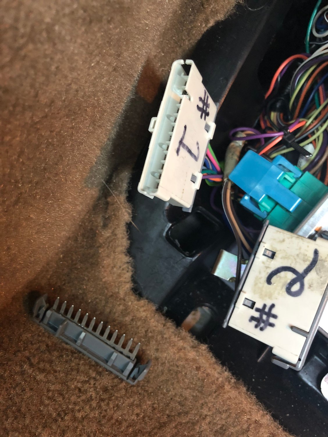

A quick check to see if you have a serial data issue...find the 2 splice packs (pictured with comb removed) to the left of the BCM in the passengers footwell...pop of the bus bar (we call it a comb) on the splice pack with the 4 or 5 wires... now turn the key on and see if all that craziness goes away !!

saw them earlier.. and played with them, did not take them apart tho
in the morning... then what will that tell me
Confirmed, the temp pins.. unplug the hair combs, and the madness continues...
i m lost on this one, i hate electrical issues.
Did you remove both combs or only the one ??...try removing both and see what happens with the key on !!...all the modules should be isolated from the network...the car won’t start but see if all the craziness disappears...and clean both combs with sandpaper or wire brush...had a member a while back whose comb looked ok but had enough corrosion to cause a no comm !!
i pulled them both out, turned the key and the bells and whistles continue... they looked fine,,I while give them a brush and light
buff with some emery cloth... see what transpires from that.

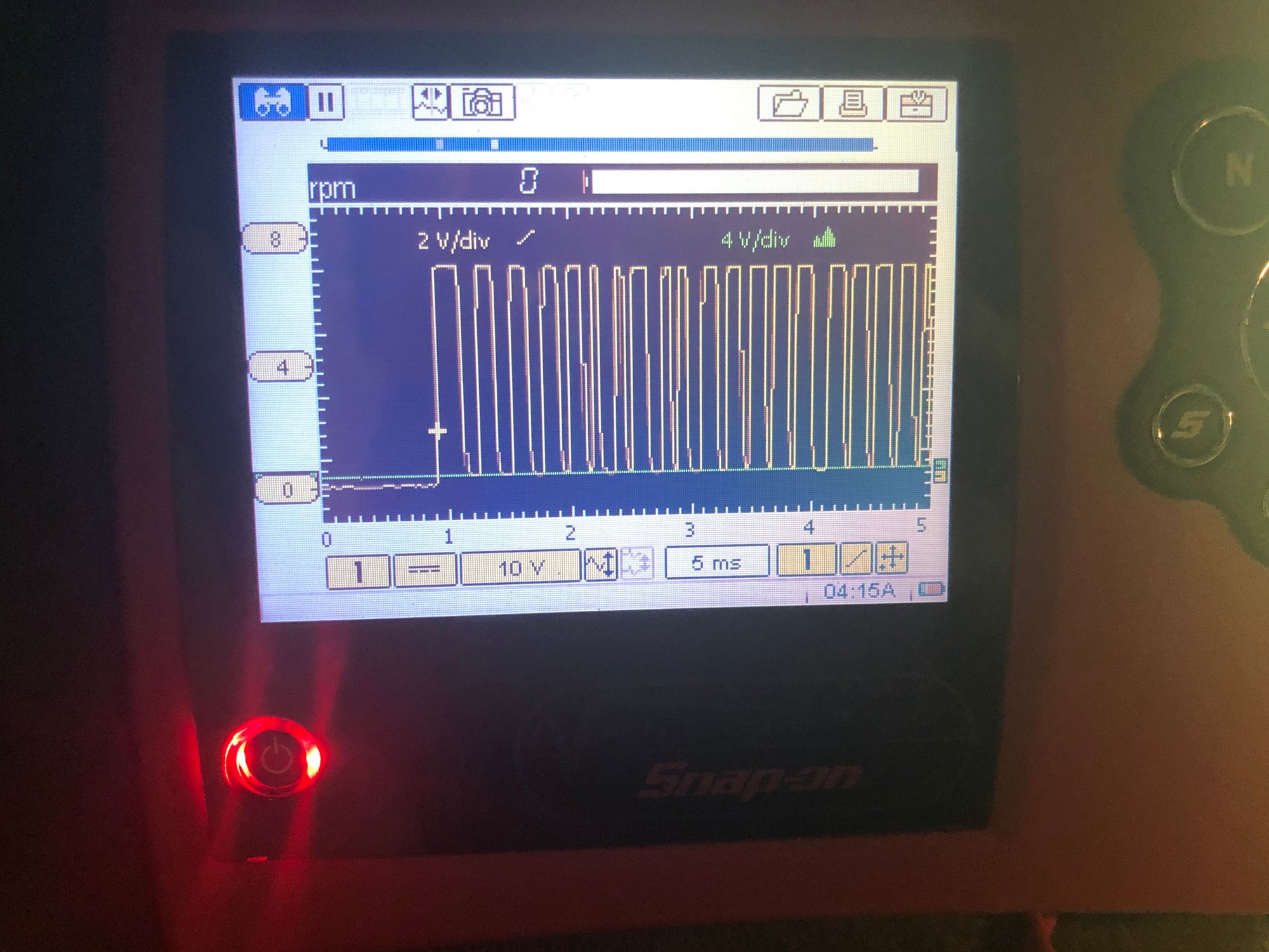

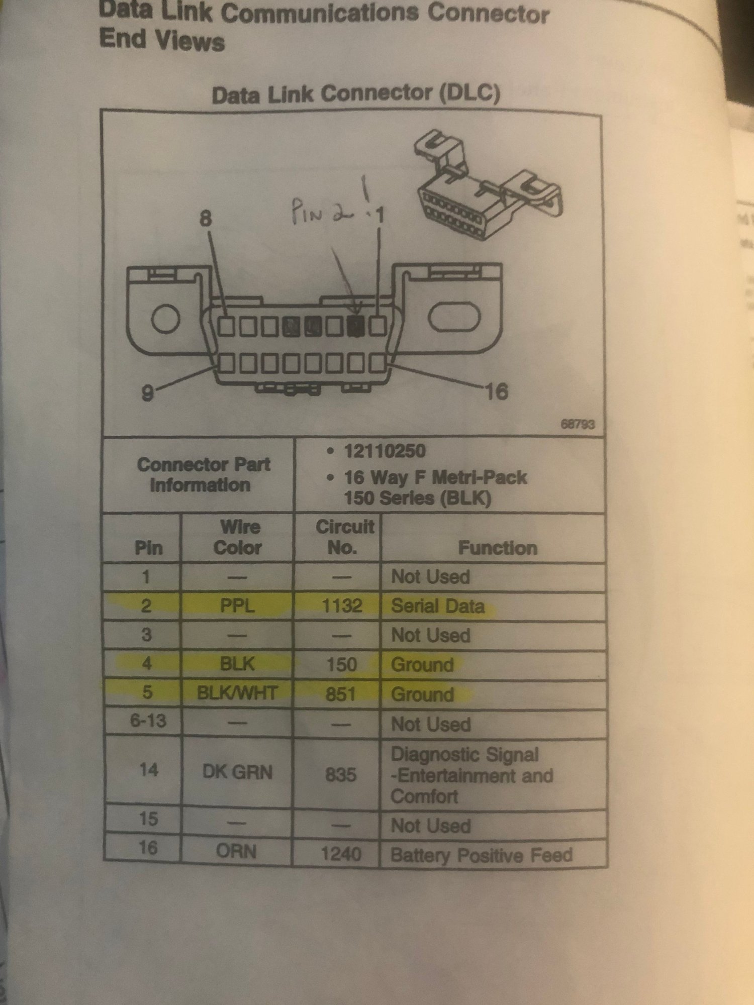

If you have a DVOM probe pin 2 on the DLC (where a scan tool hooks up to) with key on and see if you see 12 volts or ground there !!...with a voltmeter you will only see maybe .3 or .4 volts and it will be fluctuating...it is really a 0-7 volt square wave but you won’t see that with a DVOM...it’s refresh rate is too slow !!...this is what the data line looks like on my scope.
we gained a bit of headway, the mirror light now comes on along with the door lights and the hatch now releases..
still no comm tho when i go to check codes... fwiw the battery is fully charged and on a tender, did a load test on it this morning.
where do i find the DLC ?
It’s pretty far up under the drivers side. Behind the knee bolster.
