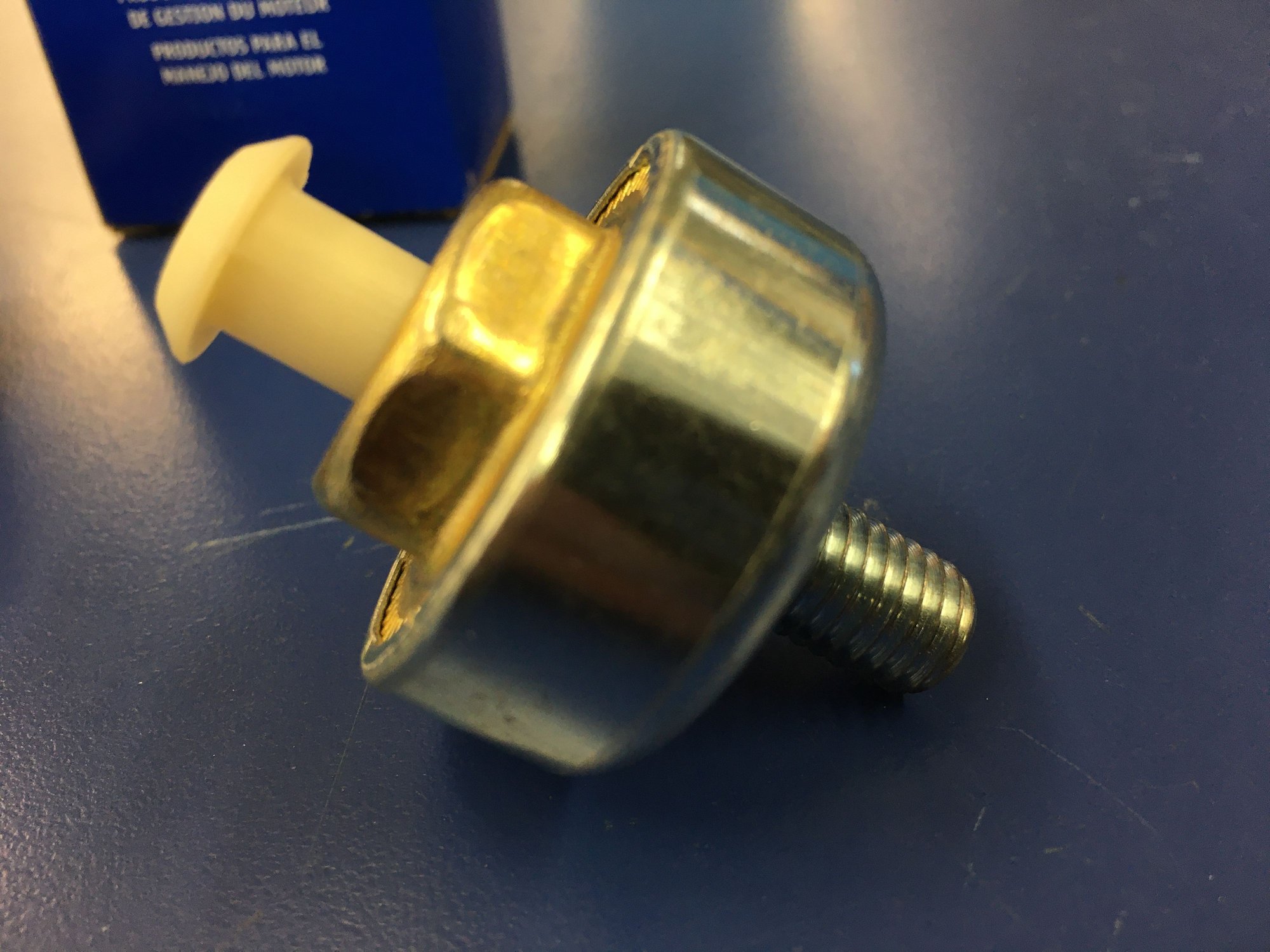

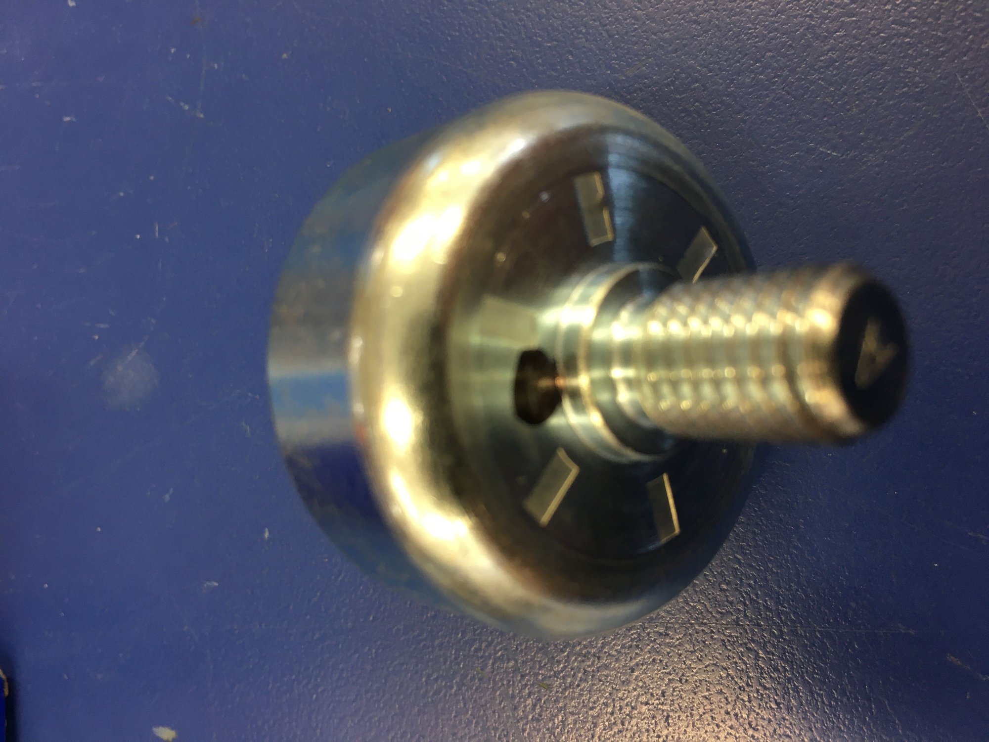

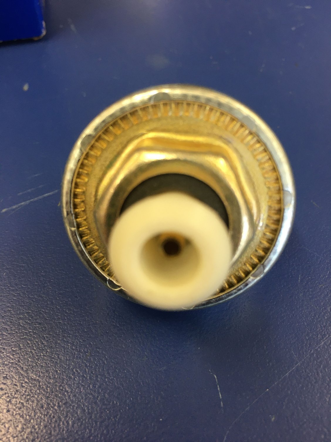

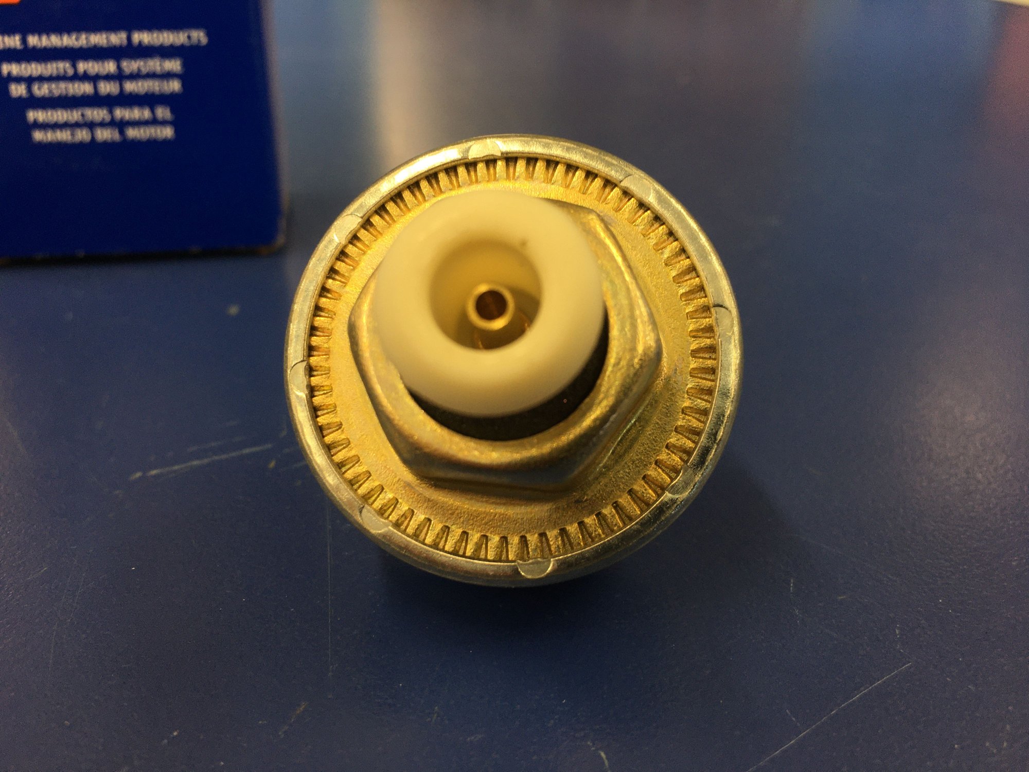

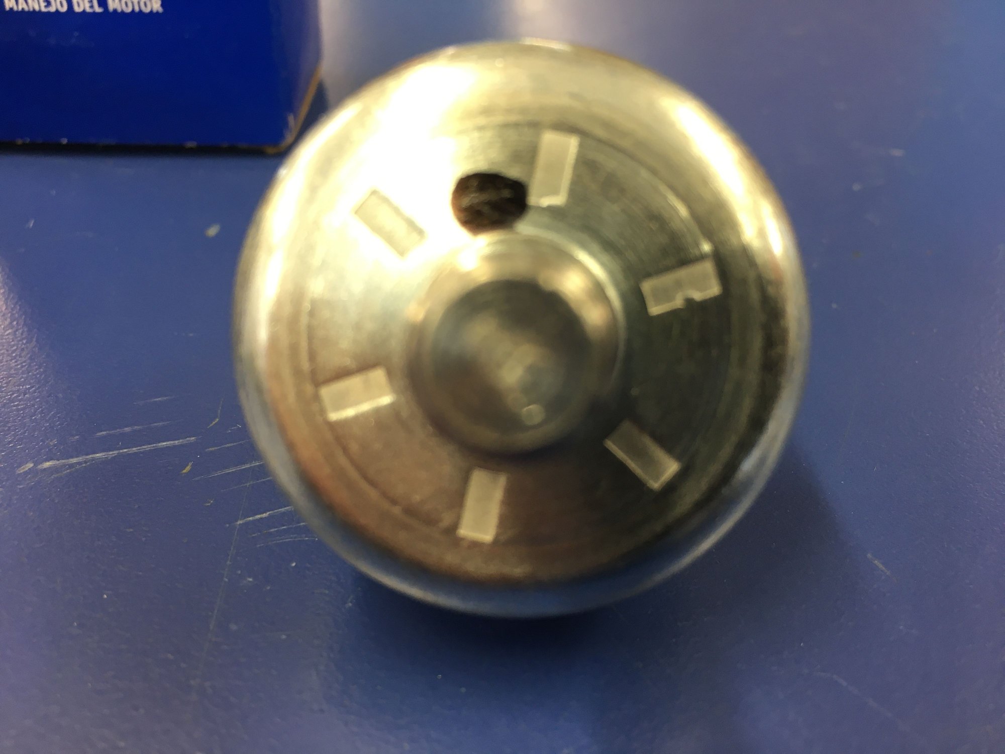

I just picked these up today. Going in the car tonight!
