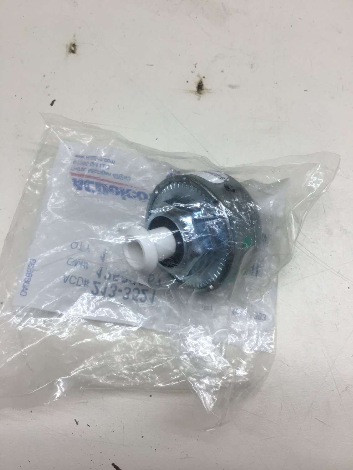

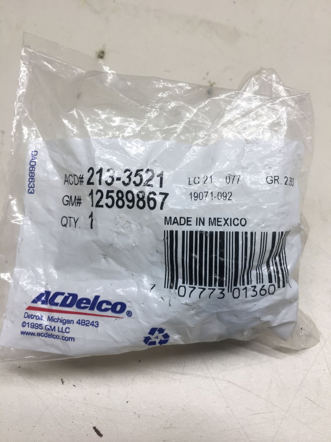

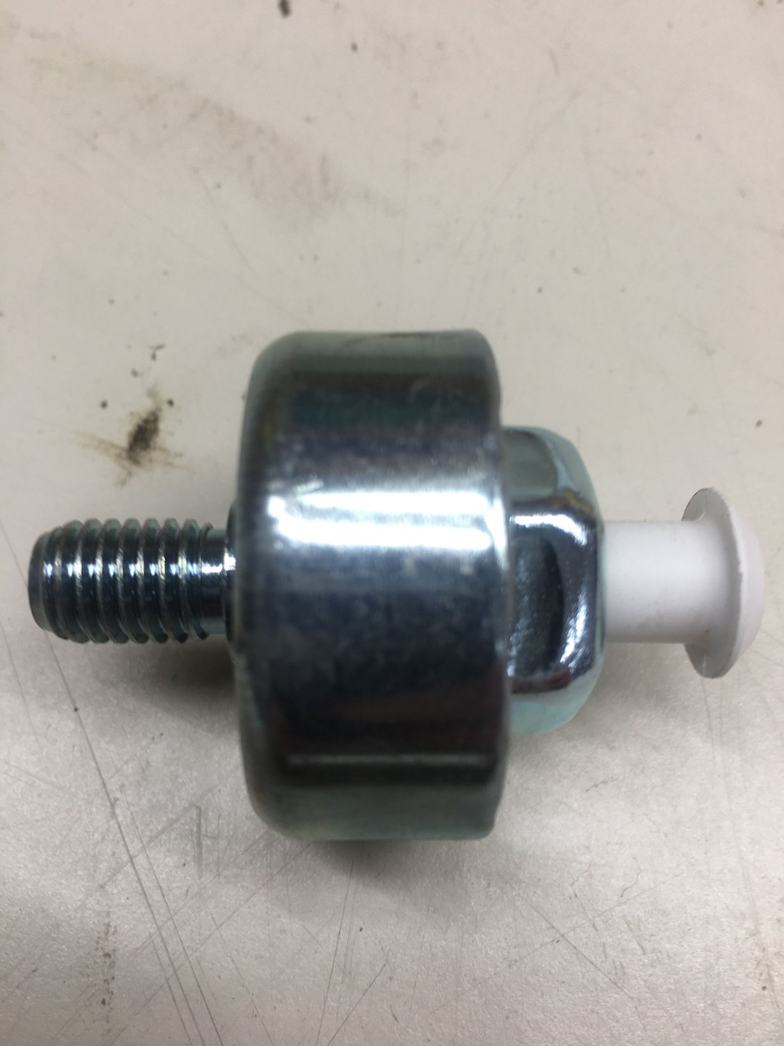

I got them off eBay. Here is the link
https://www.ebay.com/itm/202540353487

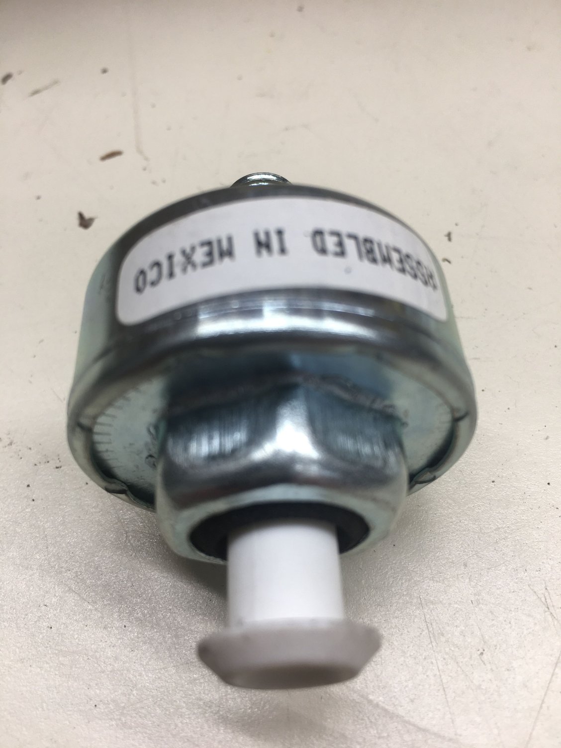

they appear to be AC Delco. But to your point, they could be bogus. Here’s two actual pictures of one that I received. They were in Delco packaging. . What do you think
[img]blob:https://www.corvetteforum.com/6fcead9e-29c2-4098-b9db-84ee61e93097[/img]
[img]blob:https://www.corvetteforum.com/c60fea93-3a2f-42b7-a93a-de0c2d1250ff[/img]

Don’t think an OEM knock sensor would have that sticker “assembled in Mexico” on it...I’d buy one from a Chevy dealer if I were you !!
yeah I was thinking the same

the eBay sensors I was getting were either defective or counterfeit. I am pretty sure they are counterfeit. I got some from the dealer A few days ago and have not had any issues.

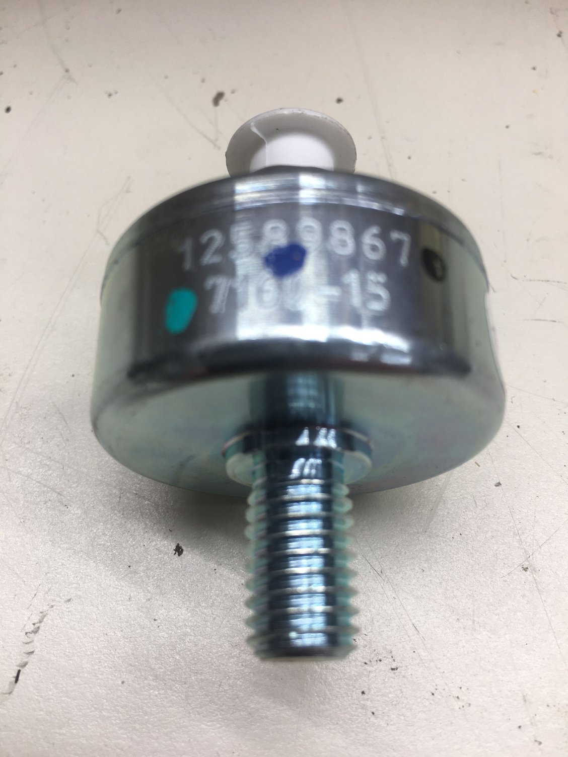

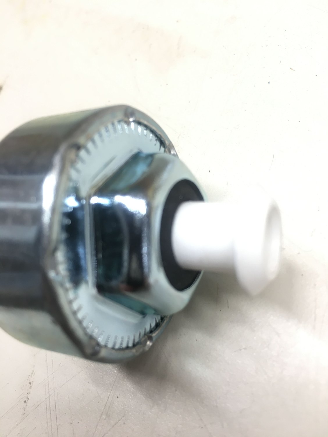

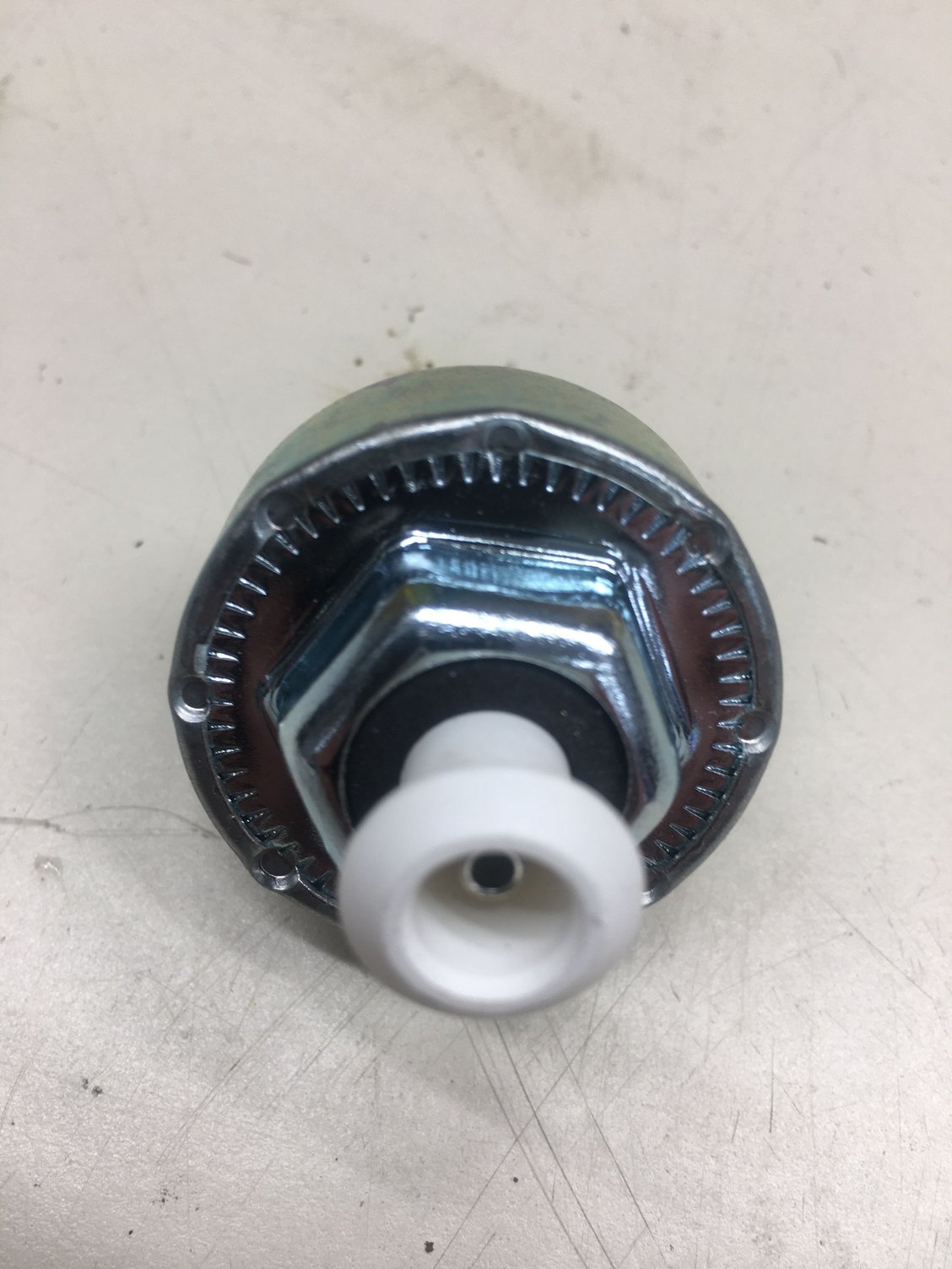

heres some pics of the dealer sensors. Some very slight difference in appearance compared to ebay units pictured above.
fpr example the electrical terminal inside is silver instead of gold. Plating on the body is difference. eBay unit has a raised edge around the circumference of the body. Sticker is different. Crimping on the body is slightly different.

Hard to tell, but does the dealer sensor have sticker on it? In that first photo, it looks like it has a white sticker while still in the bag, but I don't see it in your subsequent photos.
