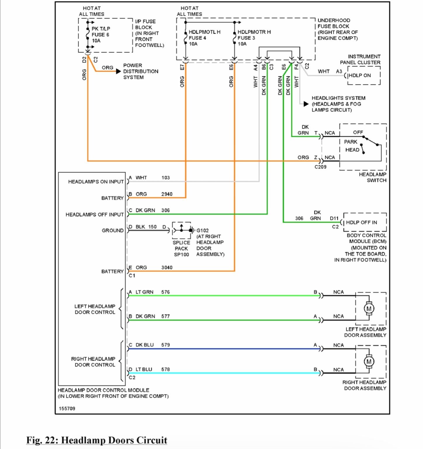

Per the manual, If the headlights do not come on the doors will not open. So your headlights and running lights are not coming on, check the relay, fuses, grounding points, or multi function switch... see attached wiring diagram...

Thanks, I think I saw you post that in another thread on here. I'm going to go out today and check the fuse and grounding points (car is up at a local shop for the oil pressure sensor because I'm just not in the mood to do it).

By that diagram it can be one of only two things, the headlamp relay in the fuse block right passenger kick panel or the Headlamp Door Control Module in the right front wheel well.
The fact that the running lamps aren't coming on directs me away from the door control and to whatever controls the running lamps which I don't see in that circuit.

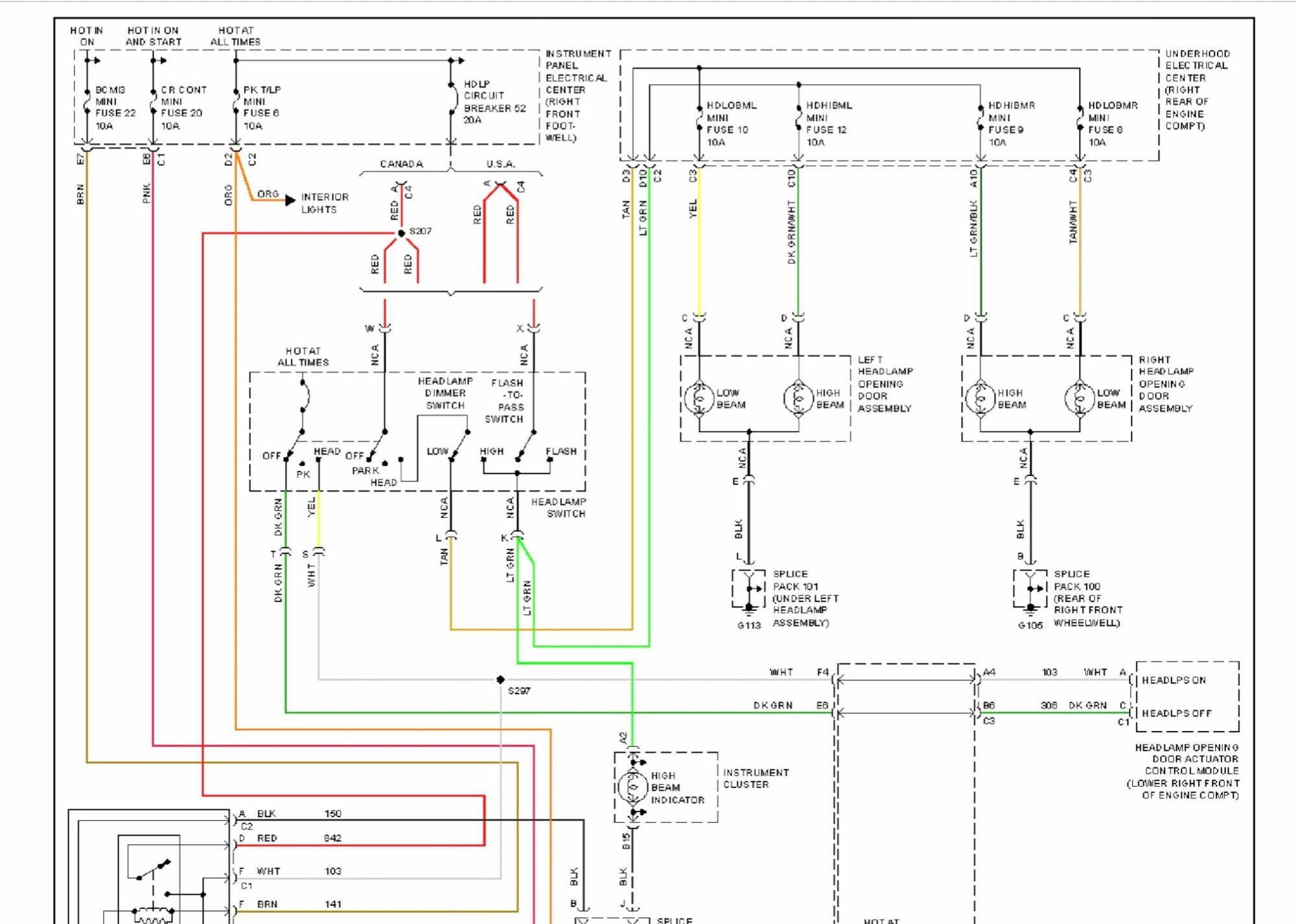

Typical when I pull back the multifunction stalk switch (Hi beam flash) when the headlight doors are closed, they remain closed and fog lights will come on.
I would use a meter and check voltage at the headlight fuses. Also check continuity of each headlight circuit to ground.
Here’s wiring diagram for a 1998... it shows the Daytime running light module.

Possibly the headlight relay? It looks like that grey line C1 / 103 coming up from the DRL controller goes to a different part of the relay and activates the headlight system.
Otherwise by the diagram, if I get running lights and headlights from the DRL control module, then it may just be the stalk went out on me simultaneously with me messing with it?
