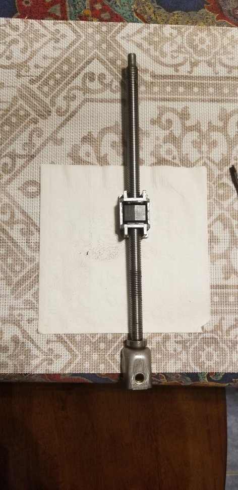

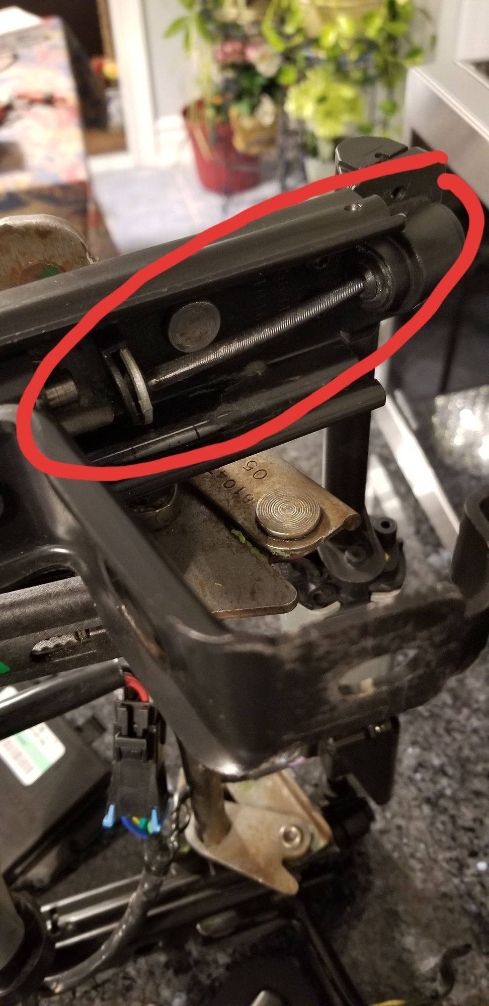

Reinstalled the track and tried a test run. Both the incline/decline on the front and back of the seat work perfectly. However, it does not slide back and forth. I can see the actuator energize but no motion. The little rod attached to the motor tries to spin, but then stops. Here is the rod I am referring to:
So, I have dismantled the rails again, but this time the rods at the end of this, are locked in place and won't come out:
Here is where it is stuck/locked (stuck on both sides)
So, I am hoping for some advice on what to do. The seats were fully operational prior to doing this. Both my flanges were broken and absolutely needed to be changed.

  1. Could the fact that the rod in the last pic that will not wiggle out now be the reason for why the back and forth function is no longer working? The same rod on the other side also seems to be locked in the motor transmission.
  2. Any suggestions on how to get the same rod out?
  3. What else can I try short of buying a replacement rail?

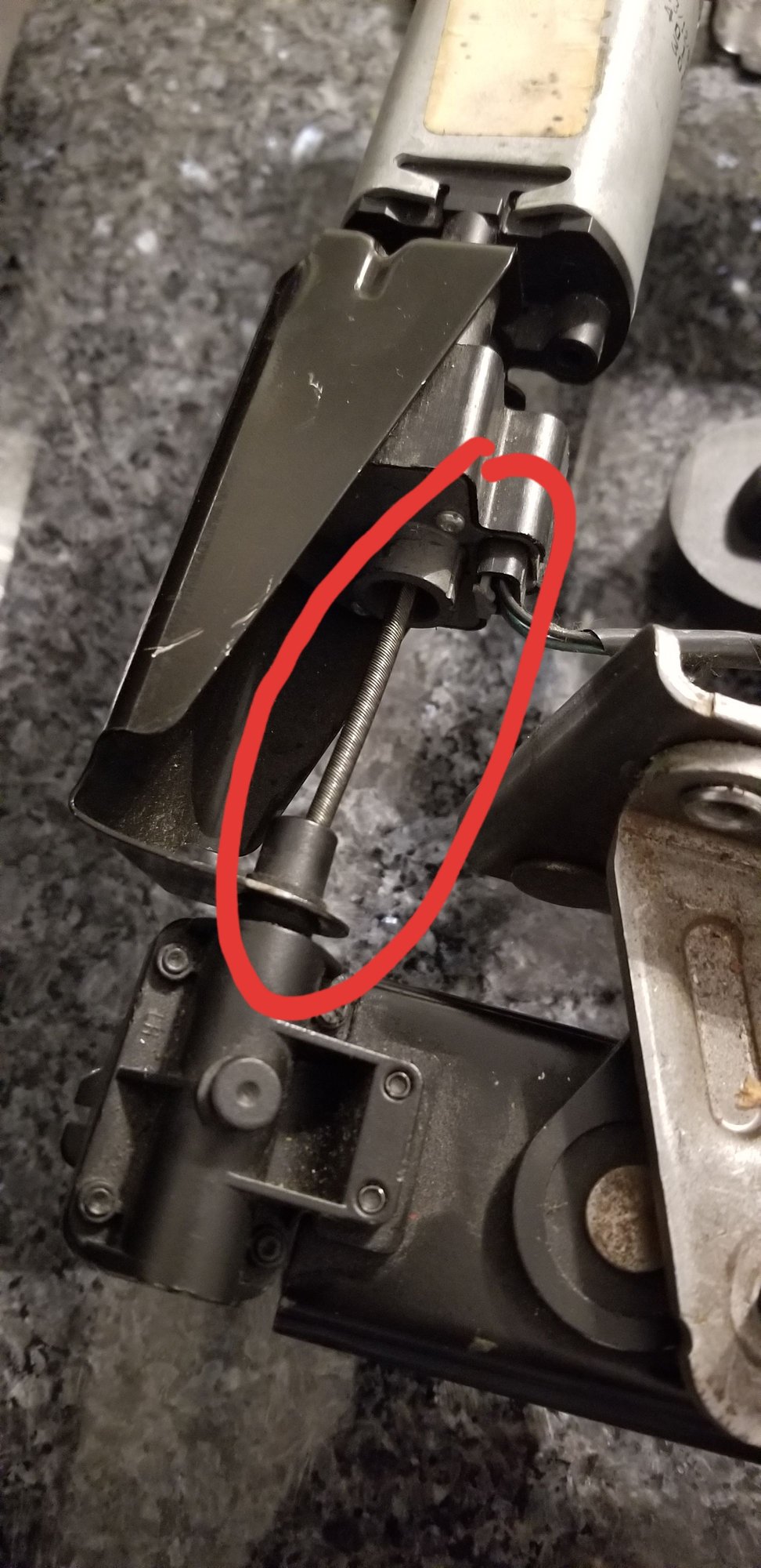

Take it apart again as per C & S directions.
The short unthreaded rod that goes into the motor (circled in red in the images) needs to be seated properly. He mentions it in the video.
I don't think yours is seated properly. You'll feel it when it seats.

i tried re-seating them. No go.

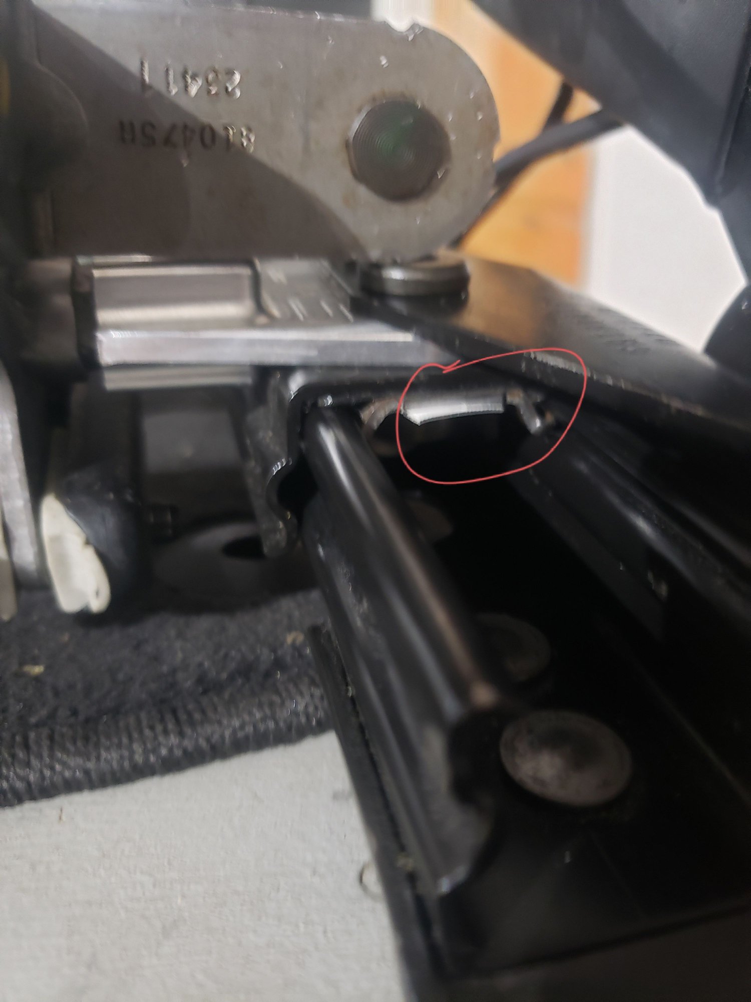

i decided to start from the beginning and test it after each step. Found the problem was the bolt for the threaded rod needed a shim on the side the c&s bracket. Seems to work fine now. I'll check back after it's installed and I've tested the durability of the new bracket

sorry I pointed at the wrong thing on the first pic. Hot tired and anxious to get this done. I left the shim out a bit to get a better picture.

Was the shim in the kit and you simply forgot to install it? Reason I ask is am am about to order this kit for my power driver's seat.

No it wasn't. I just made it out of some thin sheet aluminum i had laying around.
