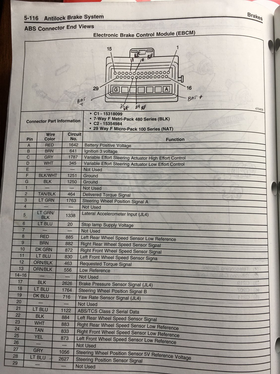

This is the page from my manual showing the connector I have

Originally Posted by Gskeeters
It’s a single connector with a 29 small pin section and a 7 larger pin section that has the power and ground.
I will jack it up and check the WSS on each wheel as described by spinning and looking for AC voltage
And check for a resistance of the WSS !!...850-1350 ohms !!….if the connector is removed we really can't check for 5 volts at pins 10 and 11...I guess if you took a jumper wire from battery positive to Pin B we can check for 5 volts at pins 10 and 11...if not 5 volts it's probably a bad EBCM !!!...I'm assuming there is a voltage regulator within the EBCM that supplies the 5 volt bias but then again you have 5 volts on pin 27....MMMM ??????
