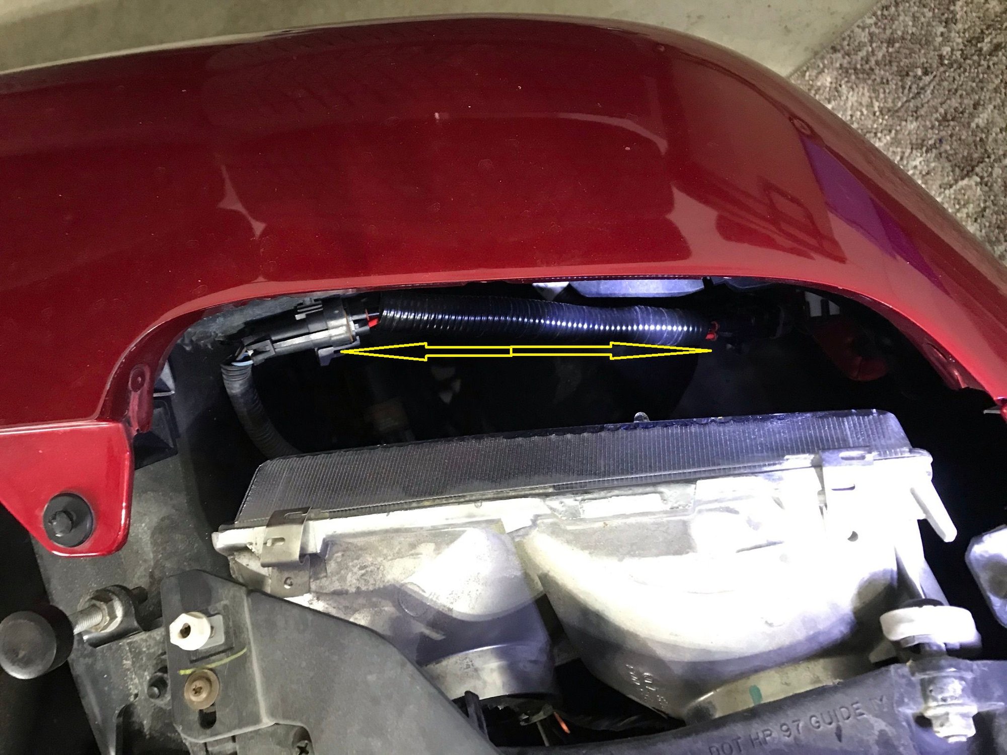

I have installed the harness and now my DRL are white!!
George at Sharp Light Innovations is very quick with shipping and offers an EMS discount. Thanks.
However, be prepared to search for installation instructions (see below) as none are included.
That being said, what I did figure out with some forum help was that it was under the passenger side light fixture. The bezel and lid need to be removed. The light then needs to be turned off in the closed position so that easy access if available. Indeed, at this point, it is plug and play. Learned a few things along the way.
