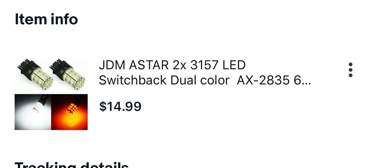

Bulb in backwards.
Should have bought the JDM switch back they are the originals to come out 1st anyways you need the hyper flash from corvette radio flyer as well.

Same problem here with Corvette Mods bulbs, their customer service said nothing they would do, will never spend another dime with them. Bought JDM's, worked prefect with a load resistor
