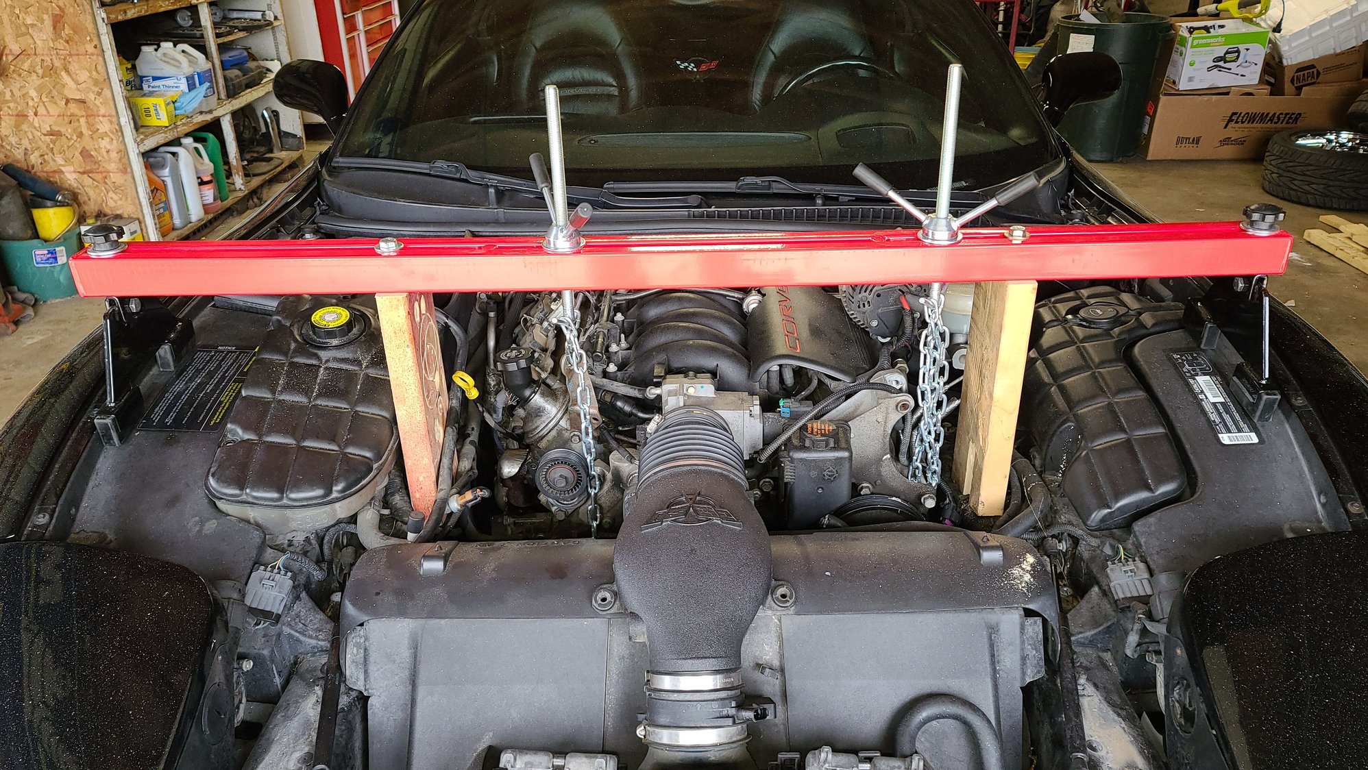

I had to remove my power steering anyways, so I just bolted right into each head with a chain to a cherry picker. I also used a floor jack behind the engine for a little more support. The cradle dropped down pretty easy after that.

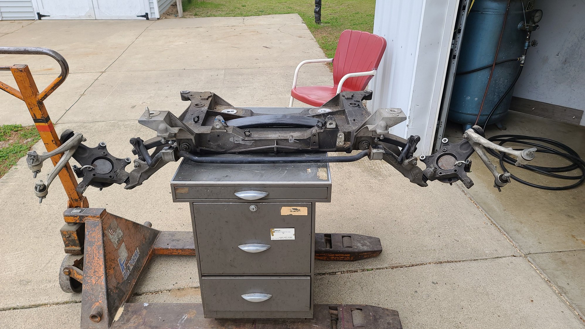

Originally Posted by indio10mtz
Hey guys I’m going to replace my front cradle as a whole. So the question is What is the easiest way to grab the motor just for support. Using a cherry picker / engine hoist. I have straps, chains, and wood.
Doing it now
