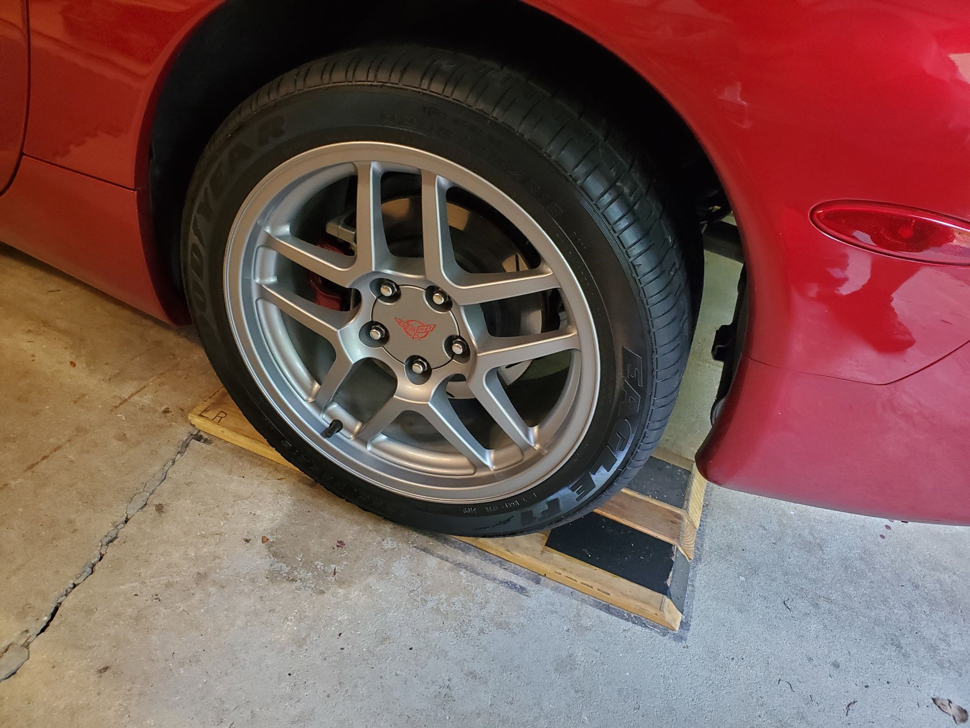

I just picked up some Z06 Speedline wheels (from an '04, I think). The tires on them have a little tread left but are 11 years old, so I need to put on some new rubber. I just ordered from Tire Rack - Continental Extreme Contact Sport SLs - 275/40/17 on the front and 295/35/18 on the rear. The rear is the OEM size for Z06 wheels. The front OEM was 265/40/17, but not many still come in this size.
