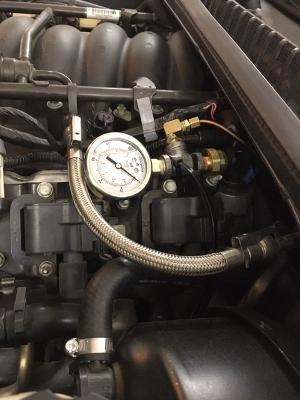

OPS sensors can go to 0, it happened to me twice, when the car was under warranty (about 12000 miles) mine when to 0 and i had it trailered to the dealer and under they replaced the oil pick up in the engine. It was a silent recall but when I picked it up, they told me they replaced the OPS as well. At 42000 miles it was a little erratic and then it went to 0 again. I tore the intake off and did the OPS relocation and put a gauge on it with a new sensor. Now I have a positive reading on the engine as well as the electronic reading. After a few thousand miles it pegged at 80 on the dash but the gauge was still reading 35 psi. bought a sensor form the dealer and have not had a problem sense.

If you relocate the sender unit, consider adding an under hood mechanical gauge. When the next sender fails, you can check the gauge to see what's up.
