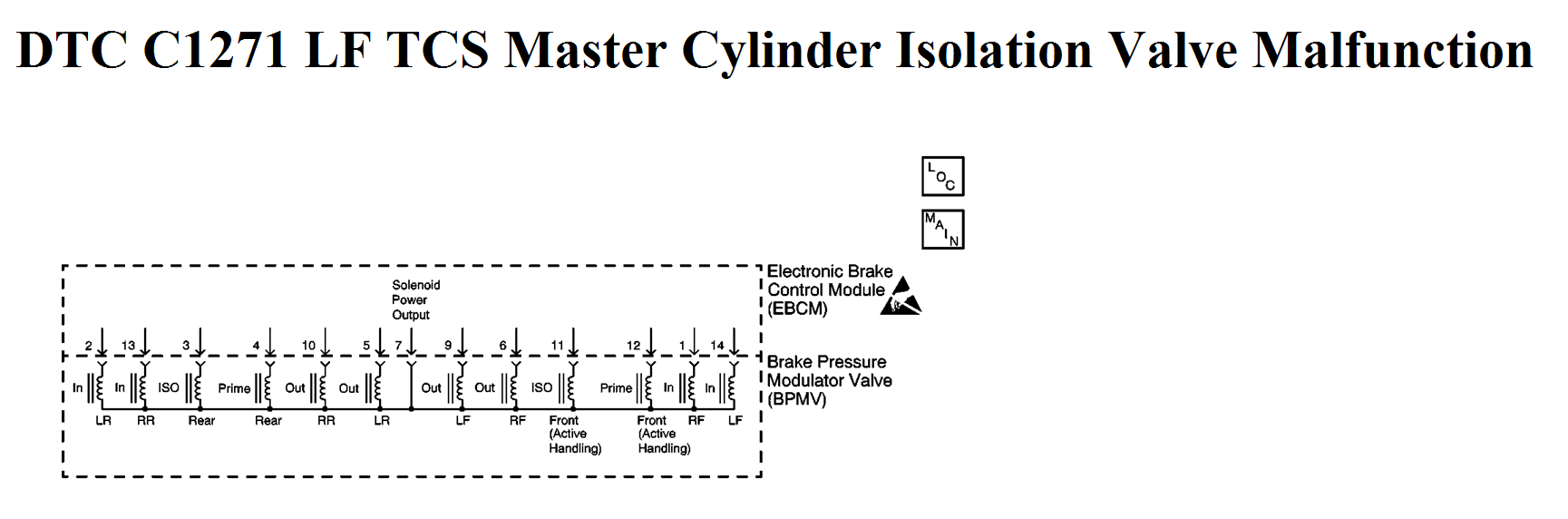

Can anyone shed some light on potential fixes for code C1271? Seems a lot of fix is re-soldering but dont think this code is the one for that.

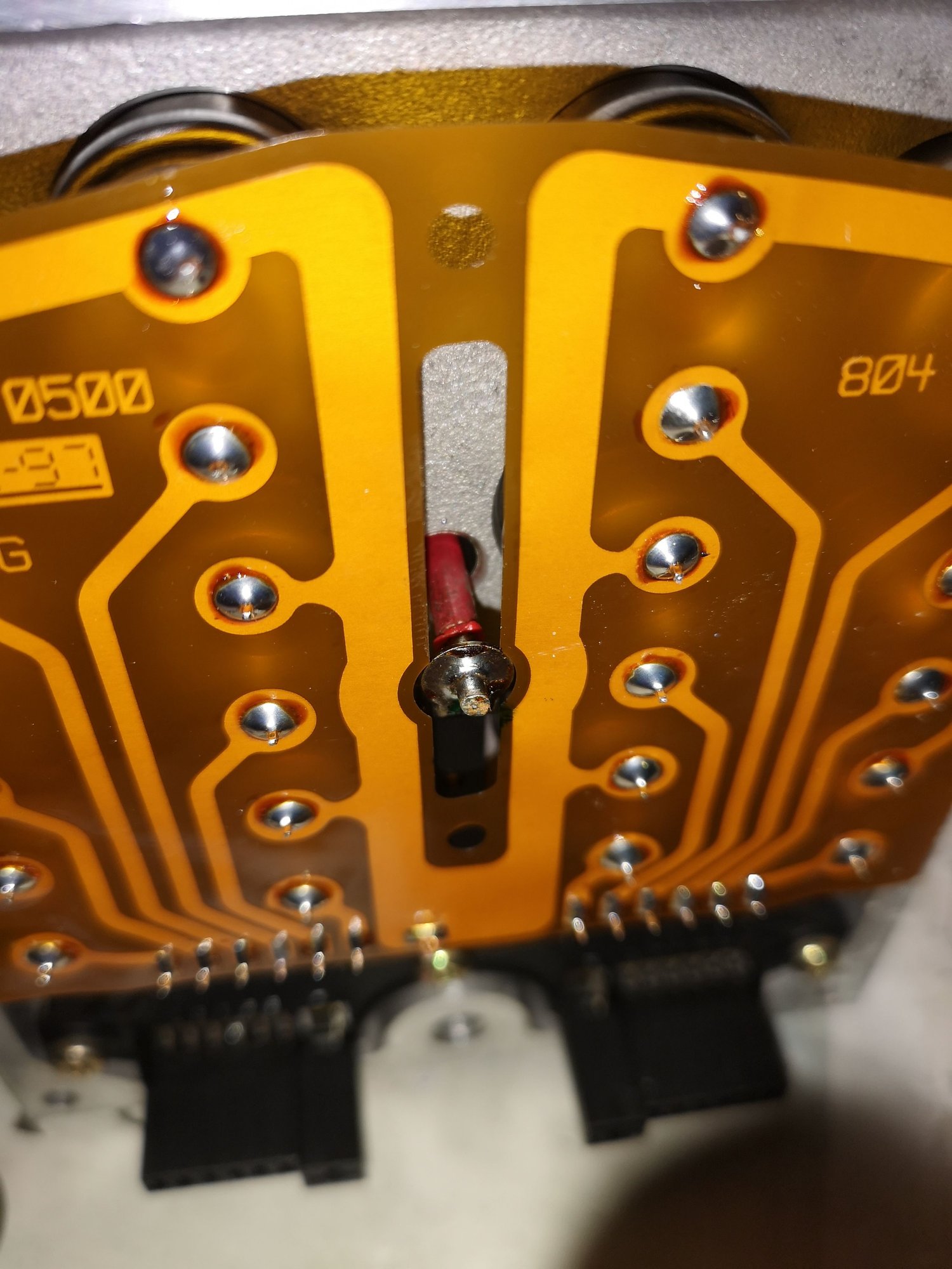

Also 1997-2000 is a different removal that 2001-2004 however no one seems to differentiate that on YouTube or anywhere else. My 2000 has only 4 screws (not 6) and only one connector (not 2) holding the EBCM in place so trying to find out if anyone has repaired the EBCM module on a 2000 or more specifically one with a code C1271.
Thanks for your input...

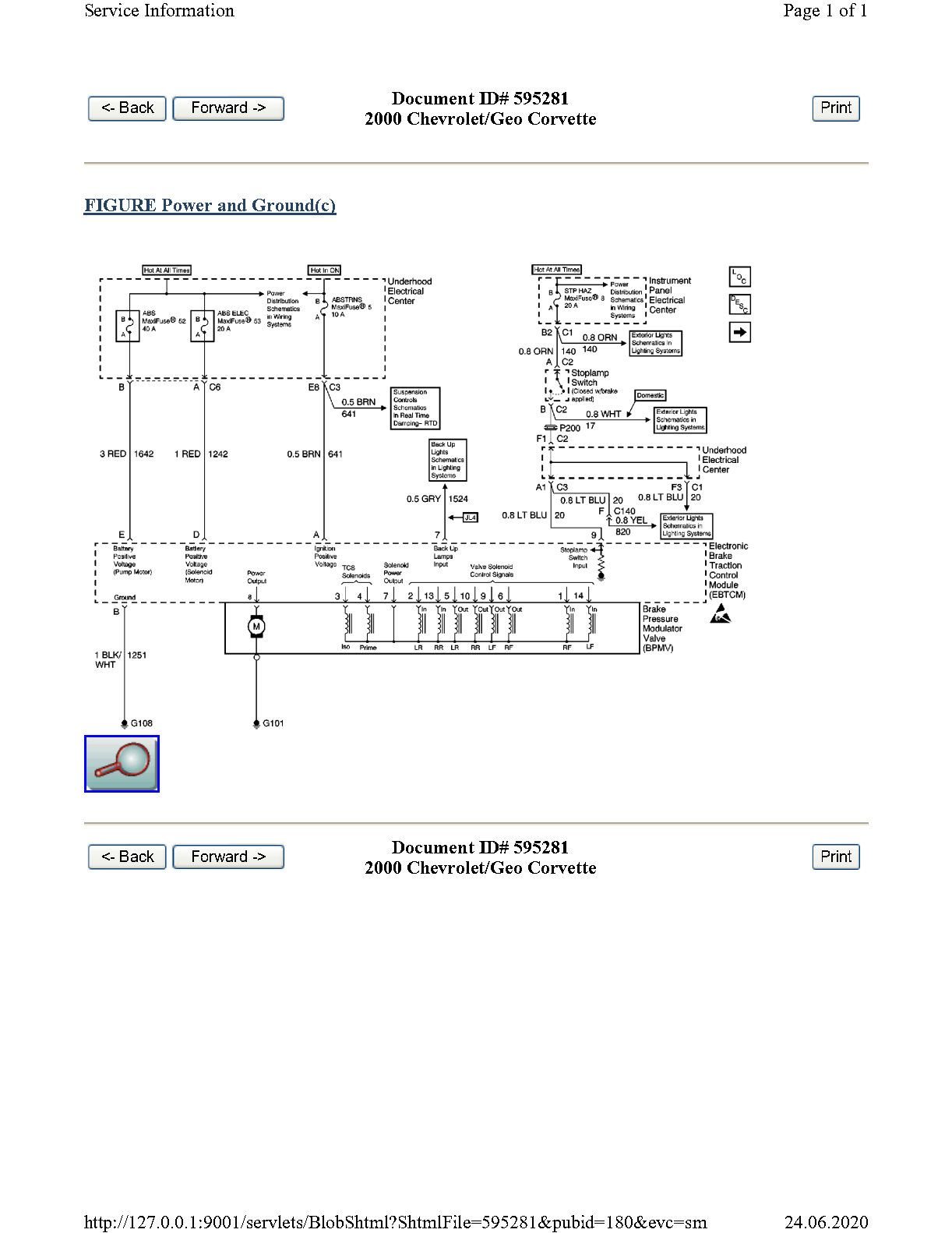

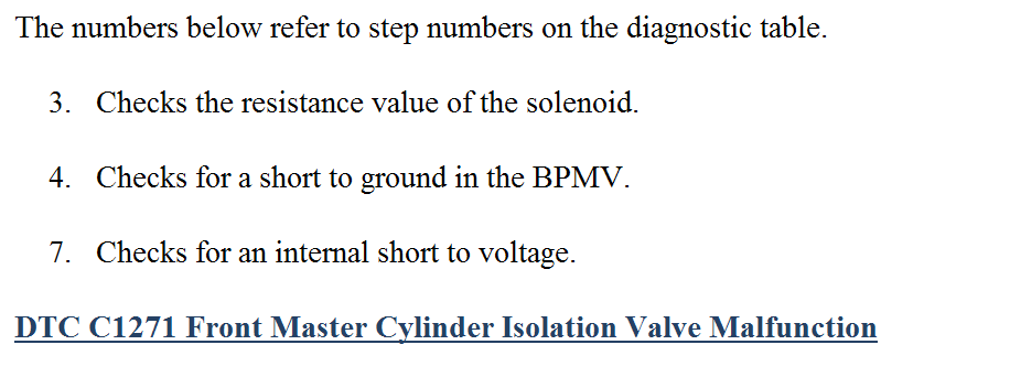

You can separate the EBCM and the BMPV and check the solonoid resistance value and for internal internal short .
You should also check if grounds G108 and G101 looks OK .
