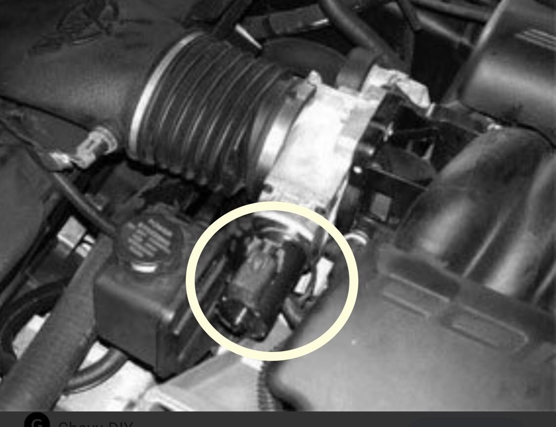

ik where the tps and tac module is but where is the tac motor at?
To Help! 04 in reduced engine power
