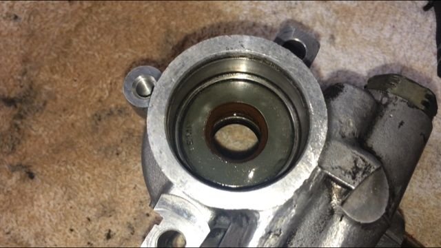

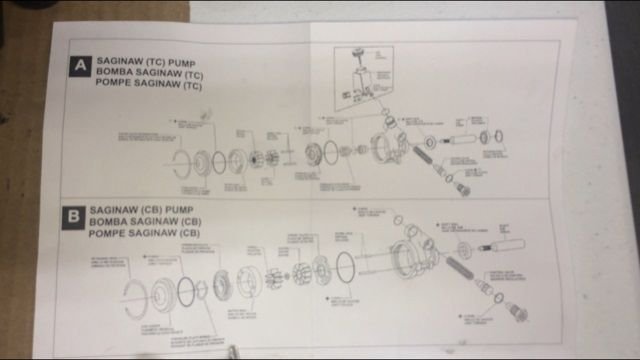

Ok, so I have succeeded in getting the pump apart. Now, I have lots of questions for anyone who has rebuilt one of these(pump #26049438). The bearing on the shaft is proving to be one helluva challenge to remove. I have literally been pounding on shaft, with a socket up around it holding the bearing. It is on there super tight. I don't know what the hell to do to get the bearing off without jacking up shaft. The pump backing cover has a pressure plate almost attached(like in type CB schematic) into it(can't get plate out) that is not shown in the type TC schematic that has the spring inside it, which MINE DOES.....but I also have another thrust plate, as the type CB has. It's like a pump with a mix of the 2 diff styles of pumps. I also have an extra dowel pin(see pic-it's smaller of 3) that was inside the pump(high pressure side, IIRC) that I have no idea where it came from(not in directions/schematics on repair parts paperwork). I cannot get the shaft seal out either(how does that get taken out?). Any help or guidance would be greatly appreciated in this project. I jumped in to try and learn on the fly how to do this, since it looked straight forward on the u-tube tutorial I watched for LS1 pumps.
