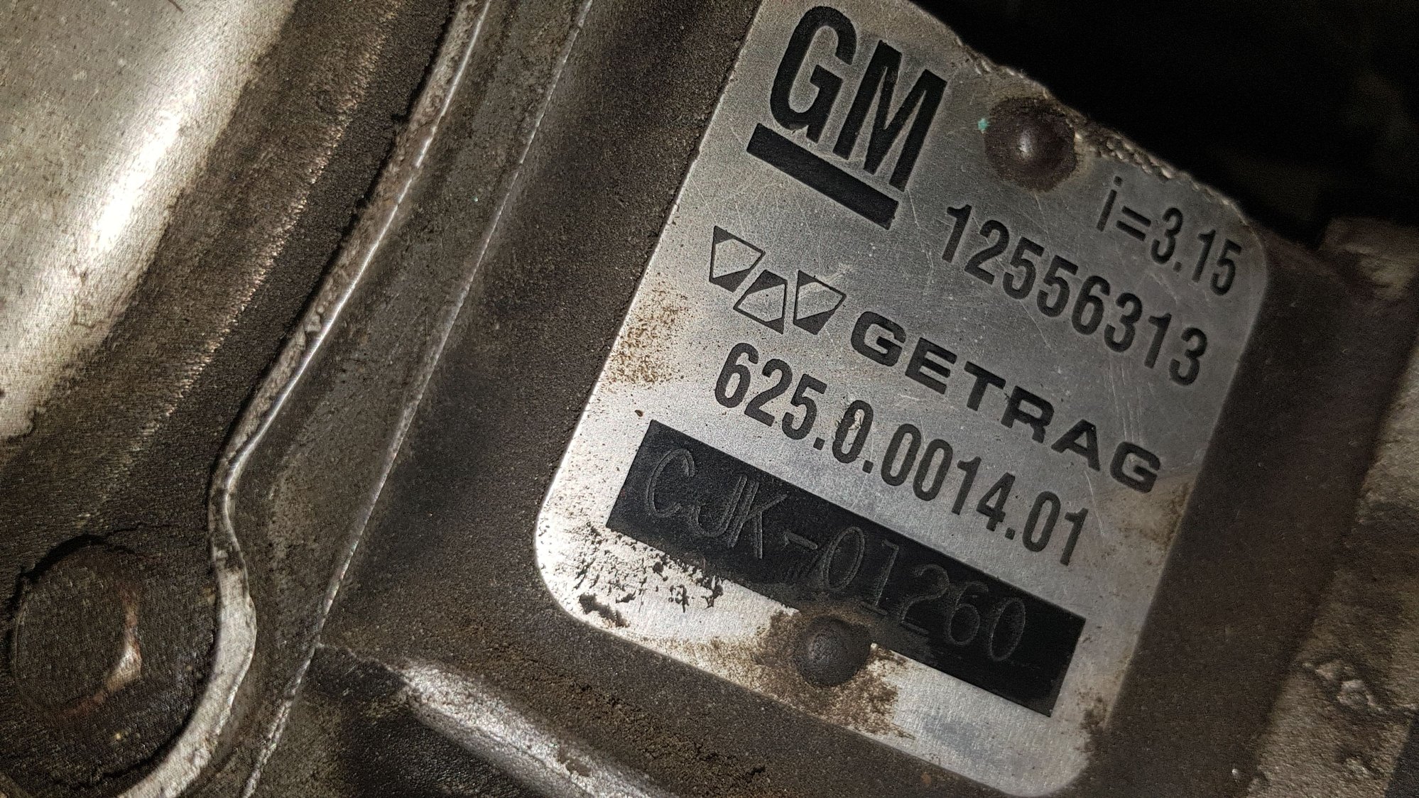

Hello guys this is my 1st post. My diff is whining on acceleration and I think my ring and pinion is shot. This happened after rebuilding the trans at a shop in my country. I need to buy a new R&P from USA and ship it here.
1) Mine is 3.15 can I upgrade it to higher ratio with the carrier i have? (attached is the photo).
2) Which R&P brand you suggest please and where Vanni but it online.

yes you could change gear ratio.

There are numerous vendors, that specialize in R&P in these States. If want some advice, try contacting RPM Transmission in Indiana; they have a website with useful information, and can email them from there, as well.
