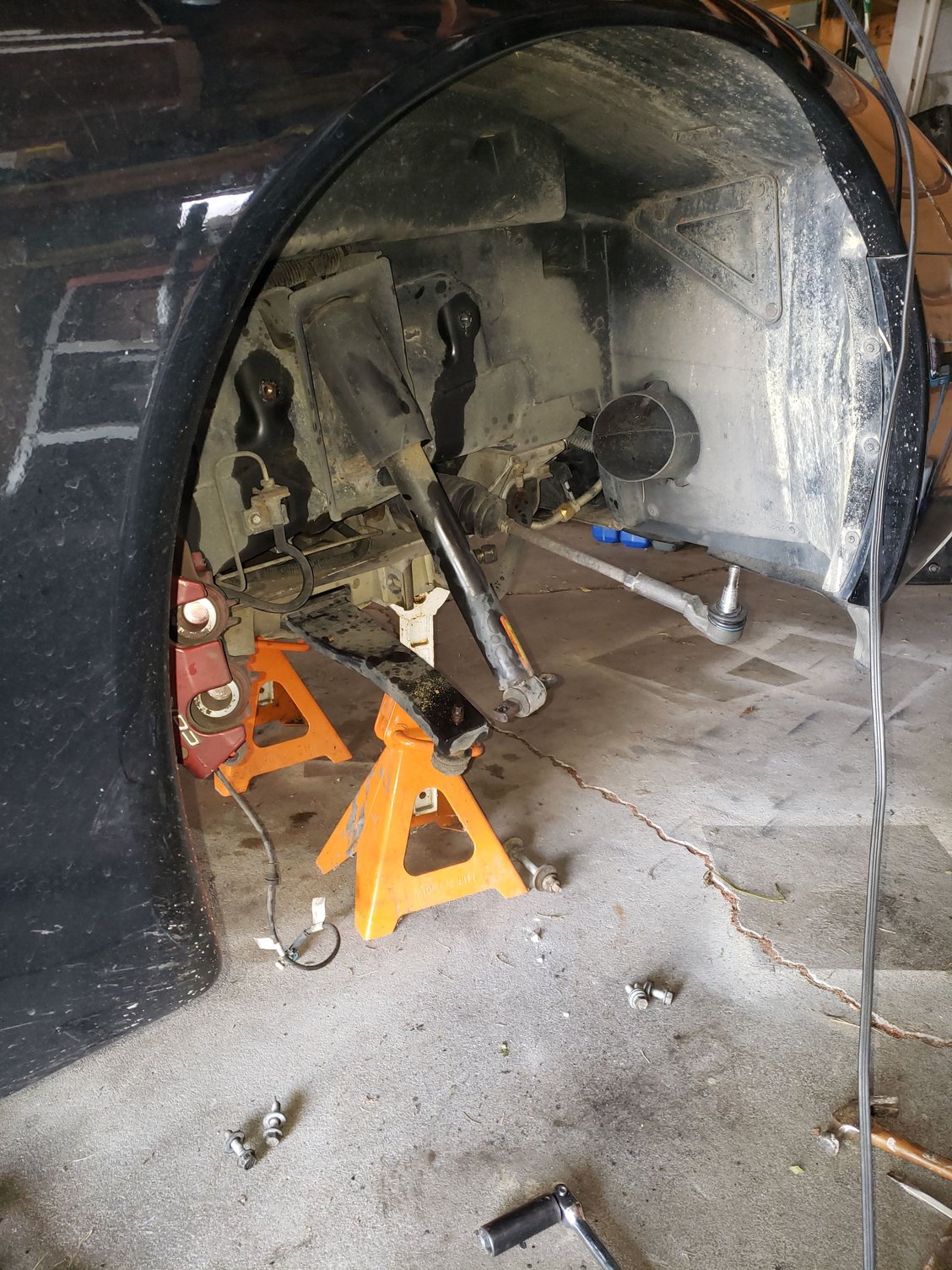

Remove the 19 mm bolts and find a press to get the bearing out you could rig a press up.

Wow I took me 5 to do a entire clutch job get this it only took the next guy 4..25 hours to do that same job . 6 hours to change bushings if your doing all 4 maybe . Just changing the rear should be be a in and out process 2 hours tops.
This is literally 2 brake caliper bolts , 1 tie rod bold and 2 upper a arm bolts to gain all the access you need without taking off the arm completely.

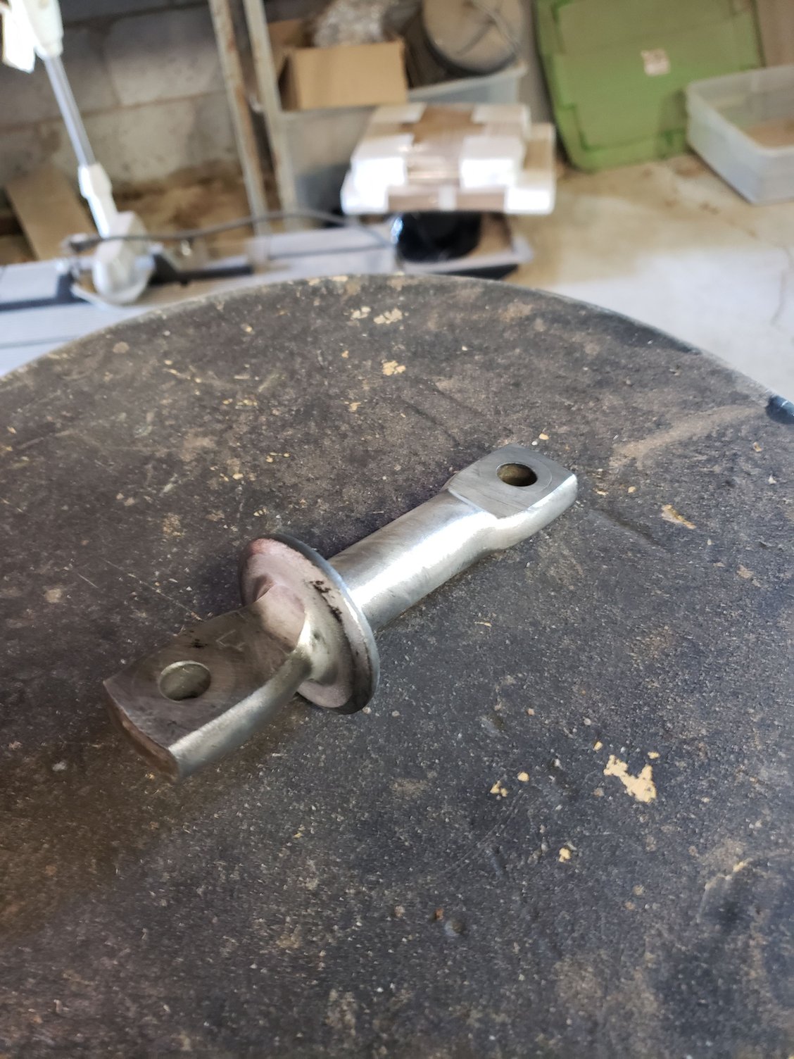

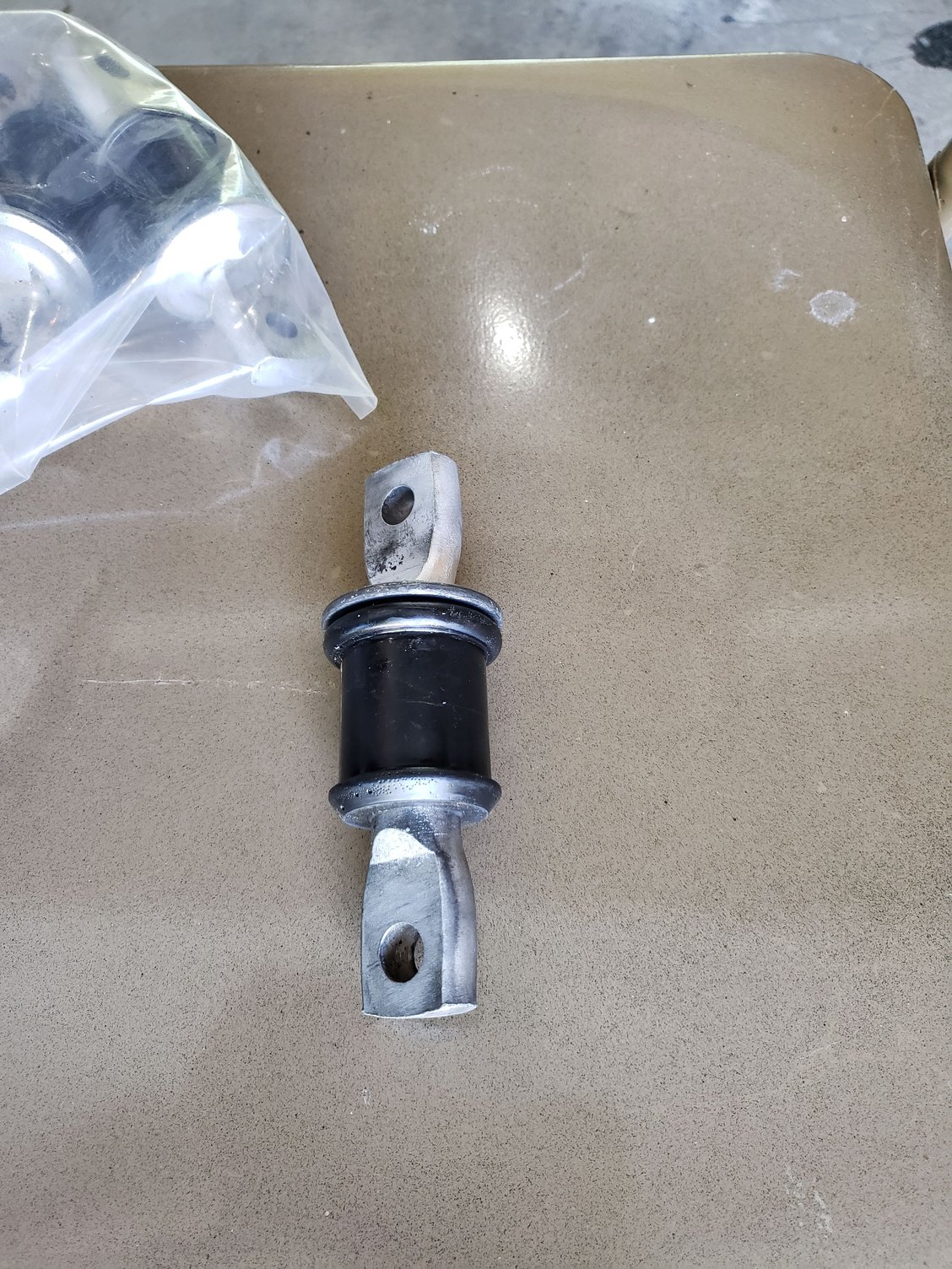

I bought ENERGY SUSPENSION bushings. The do not come with any metal hardware. Yes, once the old rubber pieces are pressed out the rubber has to be removed from the metal inserts. I lit mine with my acetylene torch. Then a bench grinder with a wire wheel to clean the rubber remnants from the metal.
It was generally a pain for each step except removal and reinstalling the parts on the vehicle.
Pressing out the old rubber was a pain. Removing the rubber from the metal was a pain. Pressing the metal sleeves and new bushings back into the a-arms was a pain.
I was in my cousin's shop and had access to a 6-ft press and two bench vices with a 10-inch opening.
But I'm a patient guy and saved a bunch of money doing it myself.
