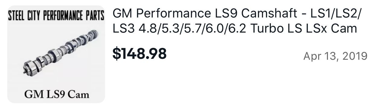

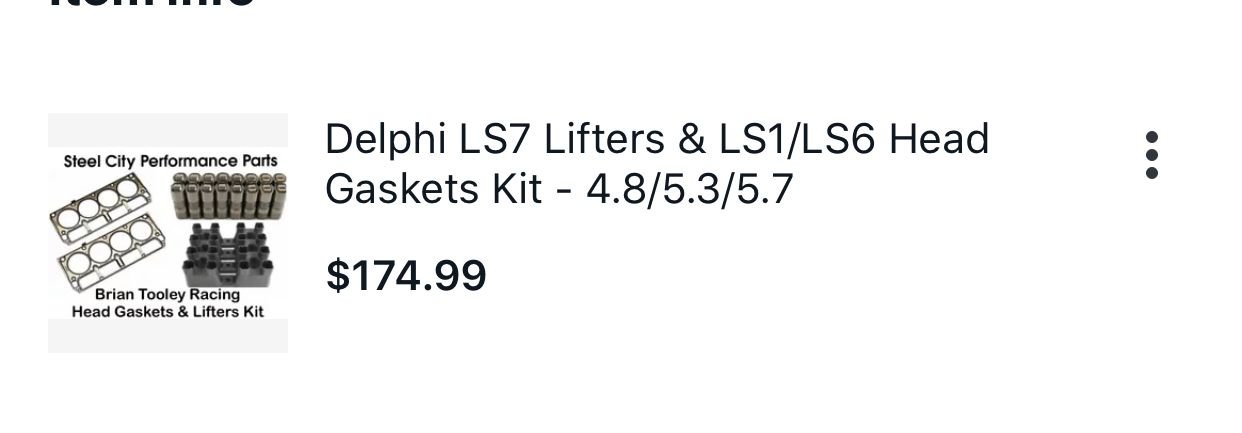

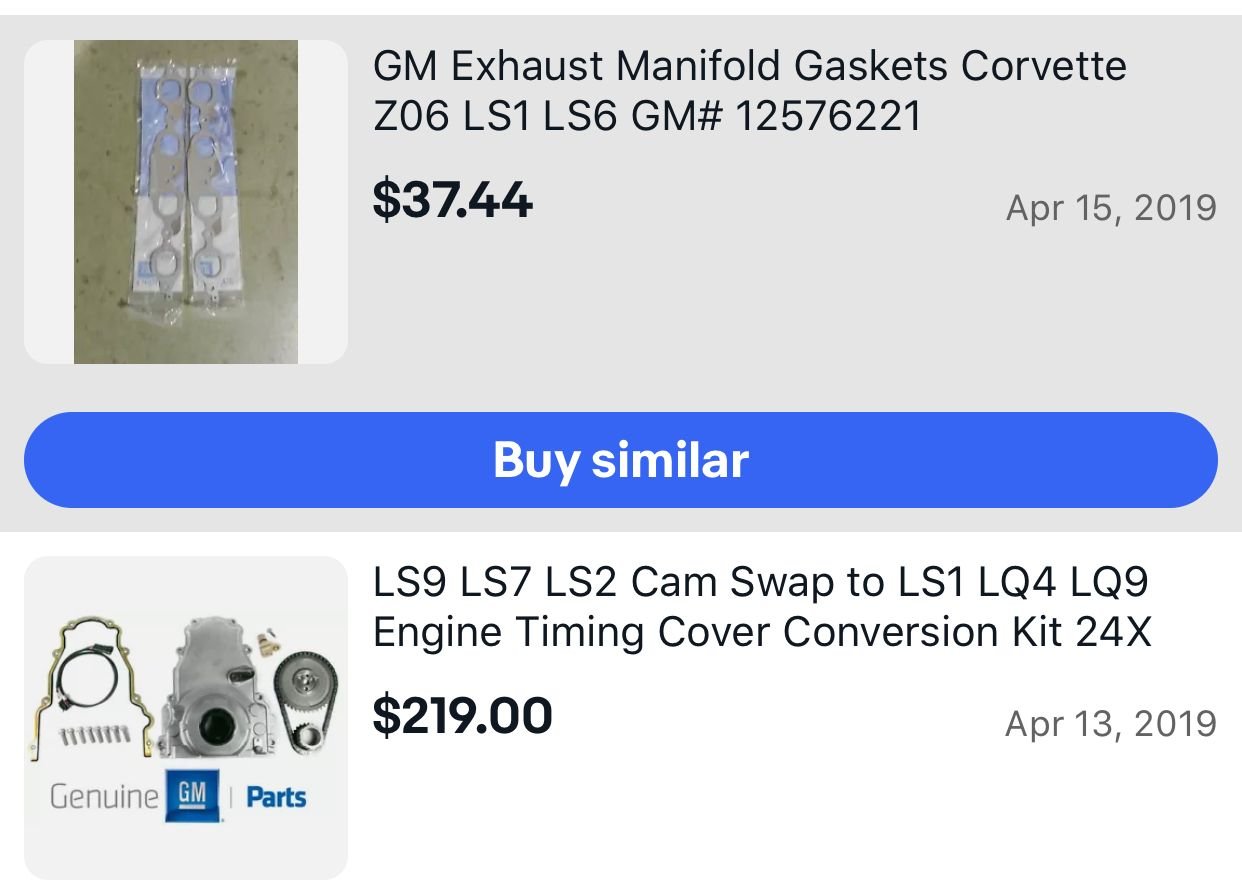

800 hp rated
Ls9 BTR
D port exhaust gaskets to match the 243 head port exhaust Ls9 timing conversion to install cam
Chrome molly hardened push rods

Along with your dual springs ect...The car should not have a issue producing 425 or so . And it will still be ready for a supercharger is you ever desire . Good luck
