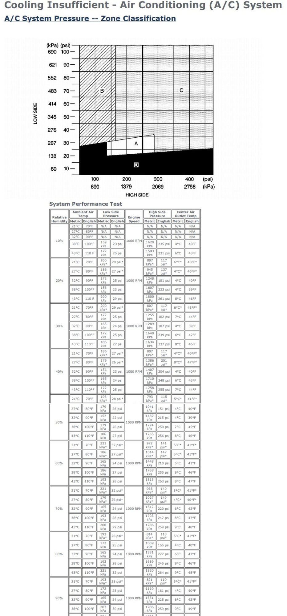

8. Compare the low and high side pressures to the A/C System Pressure -- Zone Classification Chart.
Do both the low and high side pressures fall within Zone A on the classification chart?

1999 AC Chart
Depending on your results, zone A, B, C or D there are different troubleshooting procedure depending on zone...

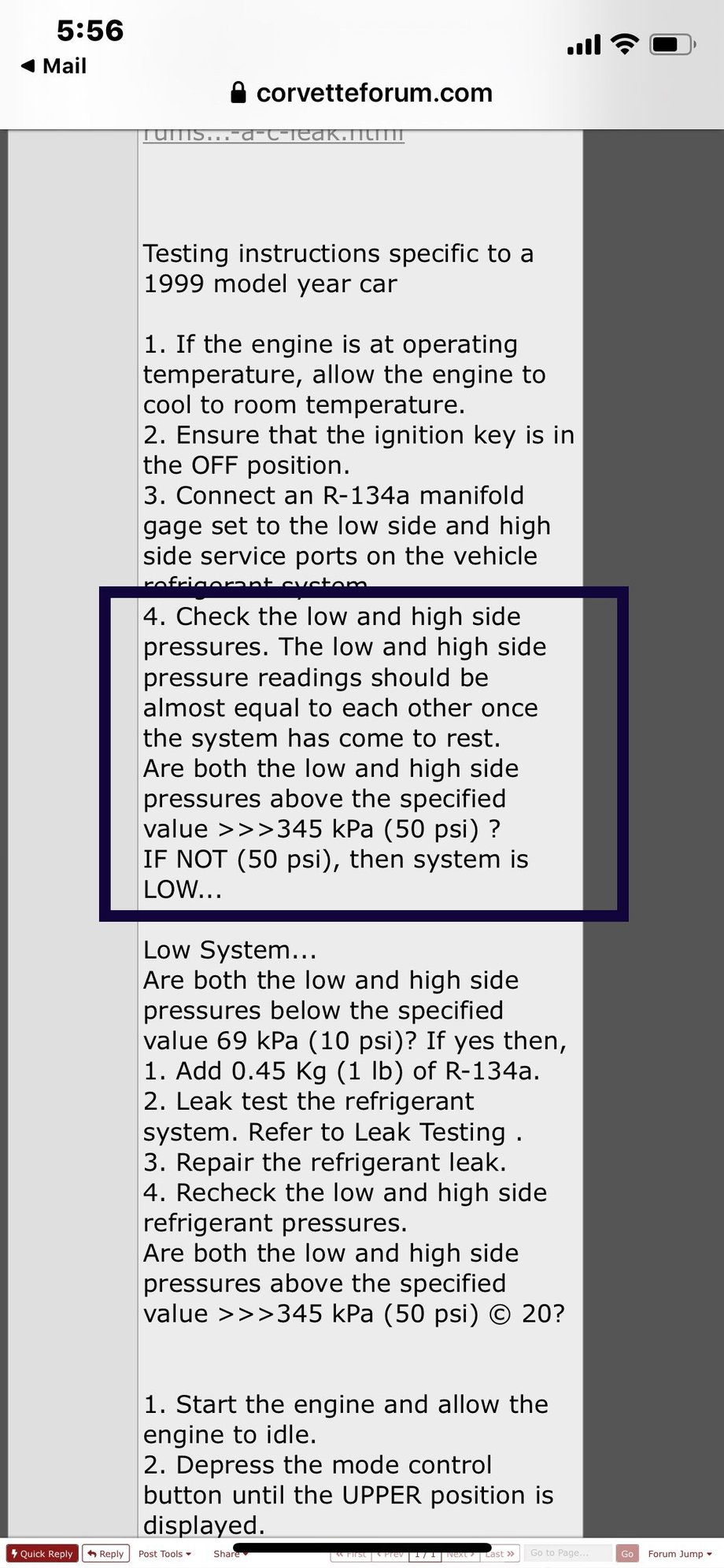

4. Check the low and high side pressures. The low and high side pressure readings should be almost equal to each other once the system has come to rest.
Are both the low and high side pressures above the specified value >>>345 kPa (50 psi) ?
IF NOT (50 psi), then system is LOW...

In step 4 your “static pressure” should be roughly equal to the outside air temp...if temp is 90 F. the static pressure should be roughly 90 PSI !!
I'm a bit confused by this statement, Can you please clarify which "static pressure" step 4?
Watch the first few minutes of this video...we call it static or rest pressure !!

[QUOTE=C5 Diag;1601906333]Watch the first few minutes of this video...we call it static or rest pressure !! [/QUOTE
Very informative video, thanks for sharing.
But as I posted>>> Testing instructions specific to a 1999 model year car can you please clarify> In step 4 your “static pressure”?

[QUOTE=69;1601906564]
I don’t know what you want me to clarify ??...this is a “general” rule regarding rest or static pressure...I really don’t follow these “factory” flow charts anyway !!...most are confusing and will lead you down the wrong path...if you have an understanding of how these various electrical circuits operate you can diagnose a 99 Corvette or a 2012 Honda Civic !!
