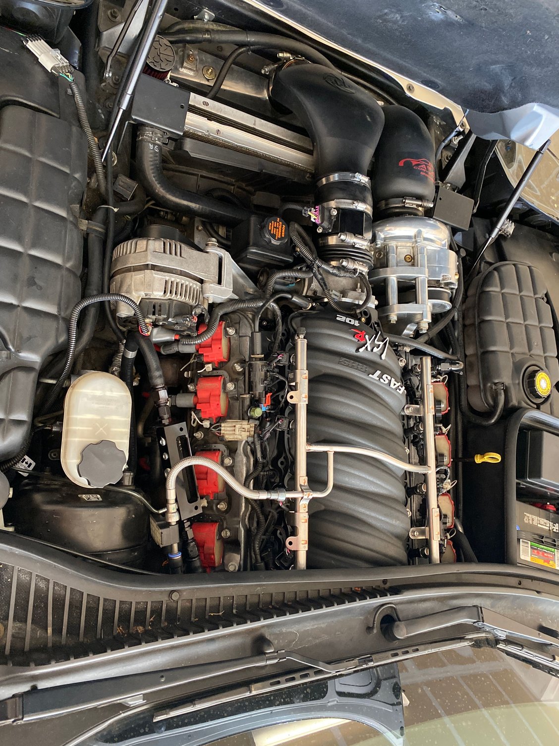

OP, do you have headers? That would be my first mod, is it auto or stick?

Lmao no worries and I appreciate truth and experience that's why I'm here so give it to me straight Docs 😅 So far I've done 1 7/8 headers, 3" catless mid, b&b bullets (love the sound of it), and vararam intake. I have a buddy that tunes and we've done a street tune and it's running great, he also can help me with the cam swap (never done that but I've been wrenching my own stuff for many years). It's a 99 FRC 6 speed manual with Z51 suspension from the factory. It's really fun to drive don't get me wrong I'm already happy with the performance.... but.... if I can do a little more and not blow it up I'm game. I did trade labor for half the cost of the car so I really only gave 7 for it and some hours of my time

I have a fully built car but my advice is to just start out simple, you already have the exhaust and someone to tune it so I would just do a cam, of course everything you’ll need to install the cam, maybe go ahead with some bigger injectors then you’ll be ready down the road if you decide to do heads/intake and I would also do some 4.10’s, just doing the cam and gears will wake the car up alot, once you start modding then you’re going to have to have things like a better clutch ect, it starts adding up quick
