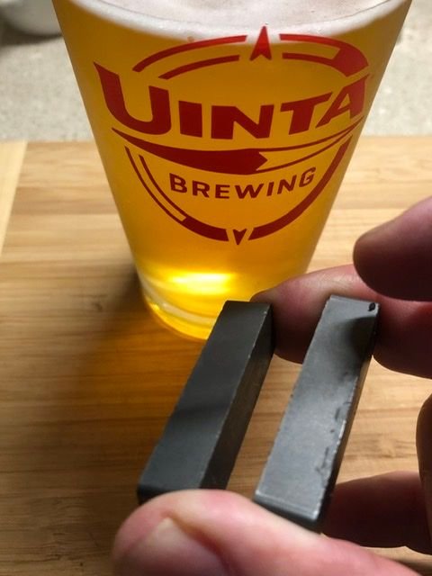

I got my wheels, tires, and sensors installed but not getting any pressure readings. Wanted to go through the reset procedure. I have these magnets and put them on either side of the valve stem - I got one wheel to honk but nothing more - is there a preferred weapon to get through this procedure?

The Amazon magnet worked the trick - but again RF was troublesome - I didn’t think it would work but then the Heavenly Honk sounded

I use the magnet in the bottom of a medium-sized magnetic parts bowl. If you're using those two magnets, which should work fine. I presume you are sticking them together and using them as one large one so the poles don't conflict.
