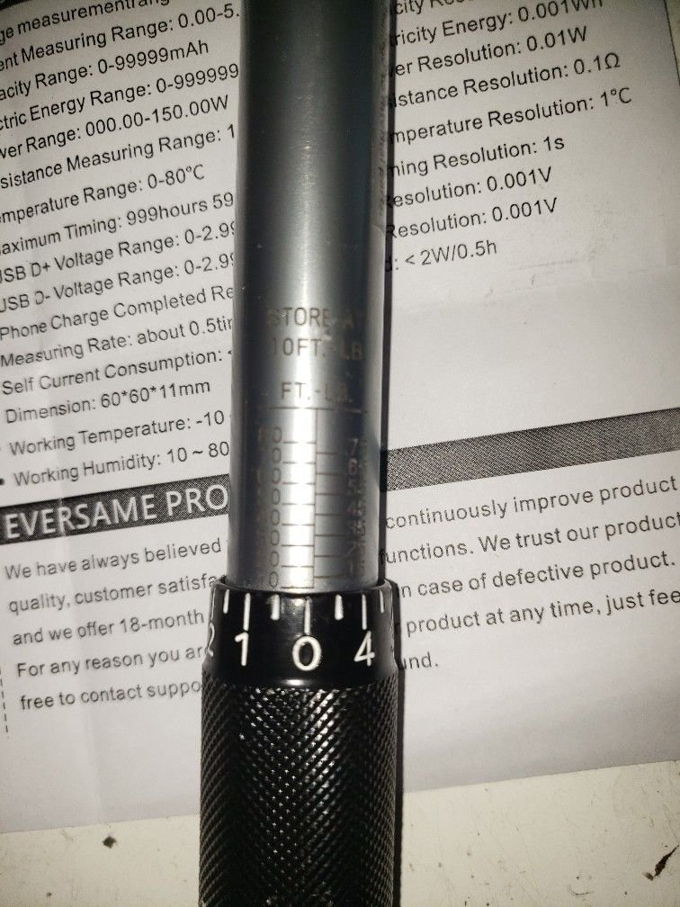

I bought for $9.99 a click type Torque Wrench from Harbor Freight Tools. On left side are foot numbers starting at 10 with 10 increments to 80 and the pound side starts on the right at 5 lbs with 10 lb increments to 75 lbs. There are two zeros on the knurlded handle.
Now for the real question: How do I set for 11.2 lbs of torgue to properly tighten positive and negative leads to the battery? To tight, I'm told can cause column lock. What is the correct way to set so I use the right amount of torque? When I mentioned to the mechanic, he said it was not necessary, he'll make it snug when he was installing the new battery.
I'm putting on the deltran charger rings/wires permanently to avoid the alligator clips when I want to charge the battery. What's the correct number and which side? L or R? What is the consensus? Thank you!!!!!!!!!!!!!!!!!!!!!!

@57gman I'm going to try to answer your question, since NOBODY has really done that yet
Your torque wrench doesn't really have 2 separate columns, one with "foot numbers" and the other with "pound numbers". A picture is worth a thousand words, so take a look below while I describe it.
What it has is a scale that says "FT. - LB." that goes from 5 all the way up to 80 with increments of 5. The scale is vertically arranged with its lowest value (5) at the bottom and its highest value (80) at the top. If you look at the bottom of the scale you will see the first marking (5) to the right of the vertical line, then the next marking (10) is to the left, then 15 to the right, 20 to the left and so on until you reach the last marking (80) to the left of the vertical line.
The rotating dial is probably marked as the one in the picture: from 0 to 5 (which is returning to 0 again) with .5 increments.
If the rotating dial is marked with increments of ".5" you can't set your torque wrench to "11.2". You would need to decide between "11" or "11.5".
Let's say you want to set your wrench to 11 FT.-LB. of torque. You have to turn the rotating dial until its edge is flush with the marking corresponding to "10". This should happen when the rotating dial has its "0" marking aligned with the vertical line of the scale. Then you turn it 2 extra clicks past the horizontal "10", until the "1" on the rotating dial is aligned with the vertical line of the scale.
This way you have 10 + 1 = 11 FT.-LB.
Hope this helps
NOTE 1: Don't forget to return the torque wrench to its lowest setting (5 FT.-LB. in your case) after you finish using it.
NOTE 2: The industry standard for mechanical torque wrenches regarding accurate range is 20% of Full Scale to Full Scale. They shouldn't be used below or above that. In your case, 20% of Full Scale (80 FT.-LB.) is "16 FT.-LB.", so your accurate range should be from 16 to 80. Therefore, using it to torque something to 11 FT.-LB. is not going to produce an accurate result, but since you want to use it for something that is not really critical, it is not going to be the end of the world either
