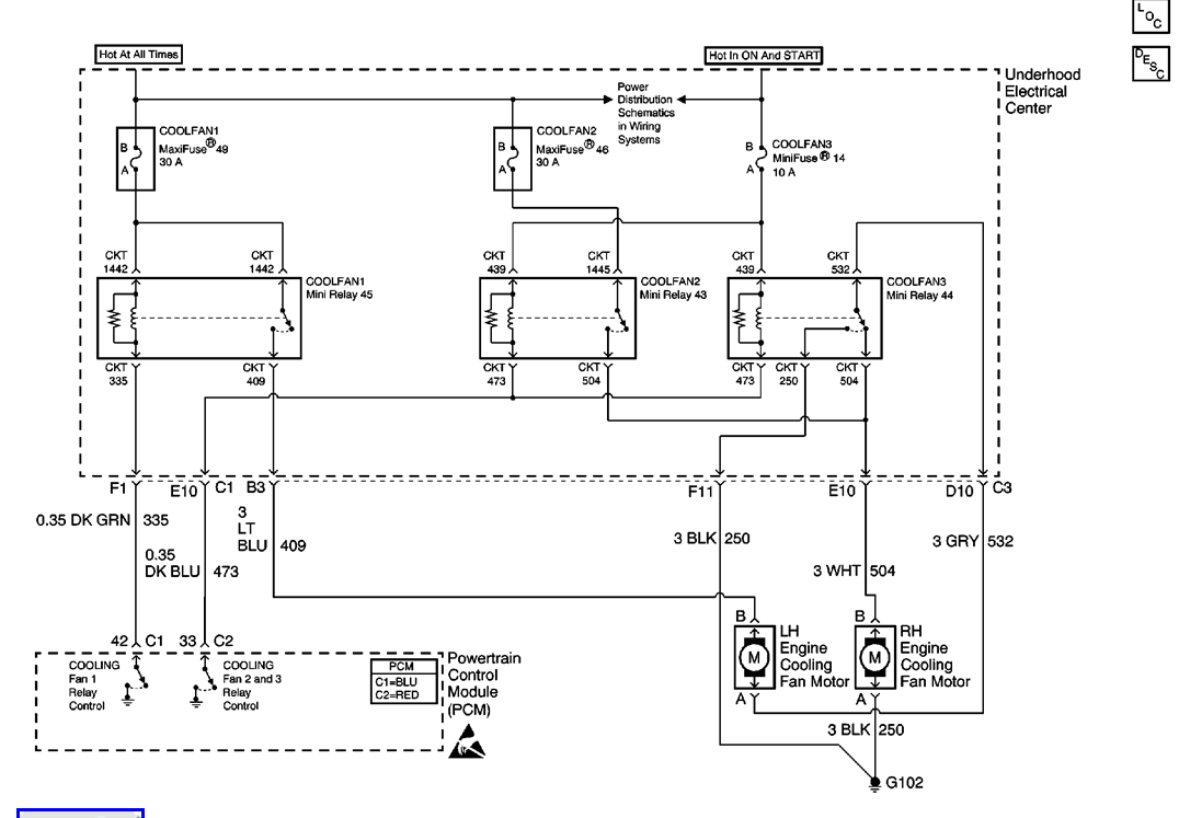

[QUOTE=wrmiles;1601983126]Yes, both fans should always run or not run together, at the same speed. I have looked at the wiring diagram and it seems that there are no relay failures which would affect only one fan.
These relays are shown not engergized in the schematic .
If relay 43 does not energize only RH fan will be affected (high speed) , while if relay 44 does not energize only LH will be effect ( high speed )

Also, if Relay 45 fails no low fan speed so both don't run AND no LH high speed and if the closed contact of relay 44 fails there is no low fan speed either.
