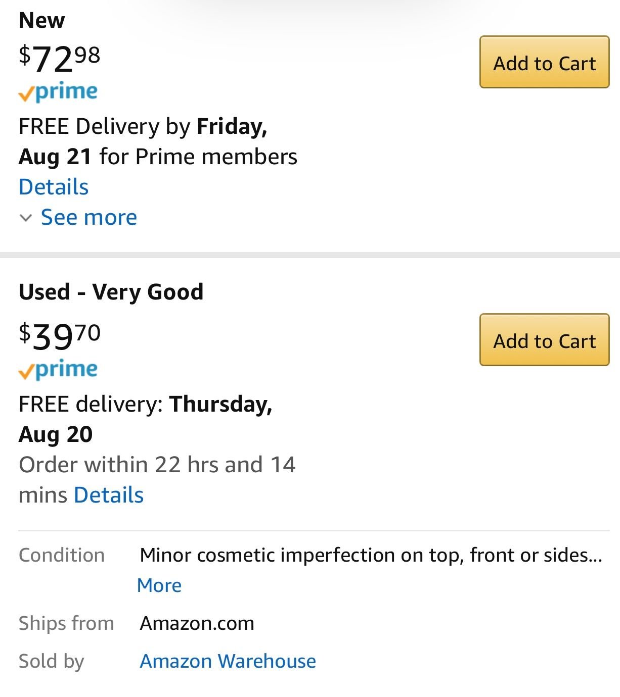

There's currently a "very good" used motor on Amazon right now if you act fast.
I have recently replaced both my motors with new motors and have also 1 spare for each side for when they wear out in the future.
