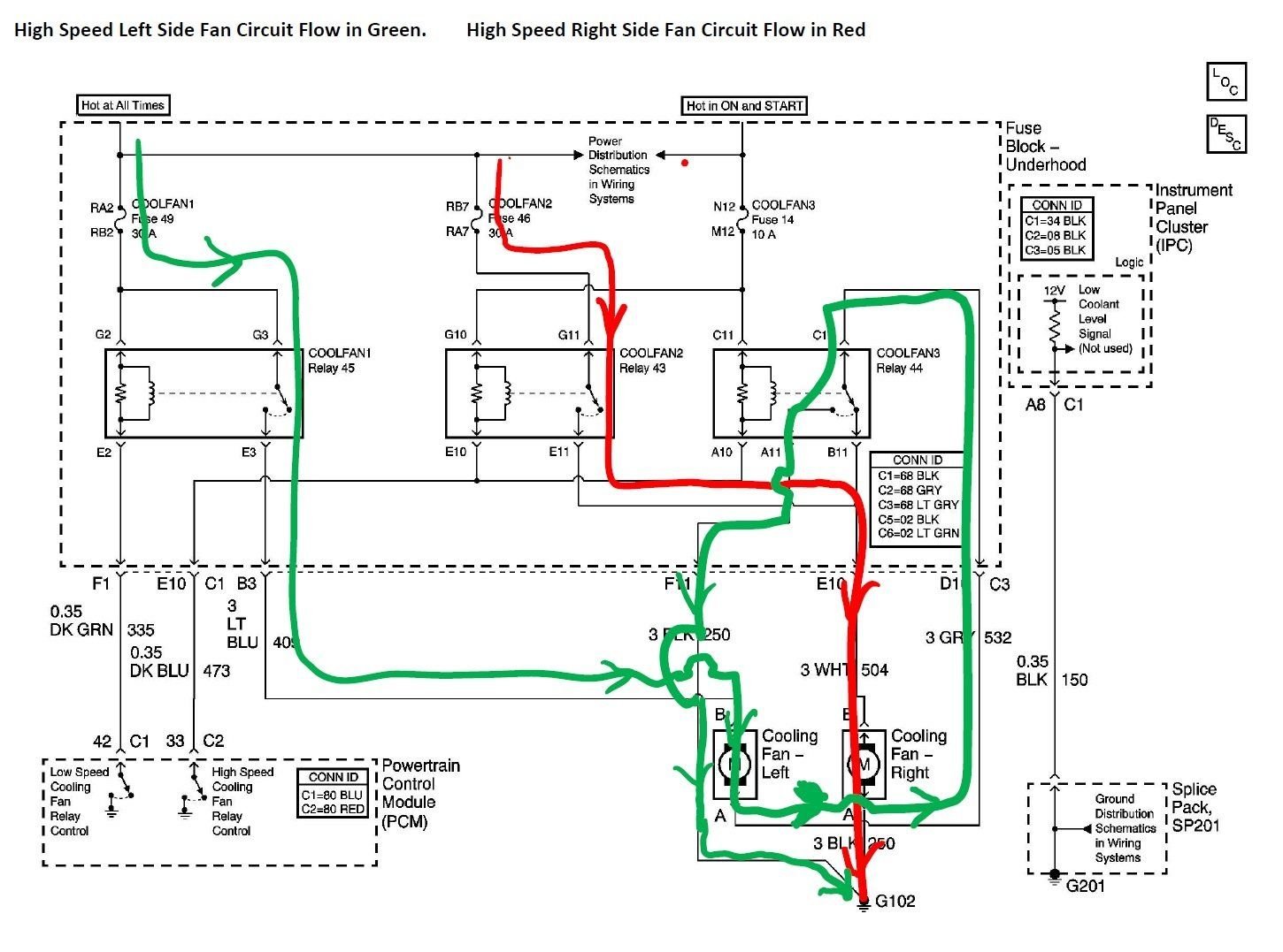

Originally Posted by JDMricist_03
...it looks like the drivers side fan isn't spinning but the passenger's side fan turns on at about 225ish. The driver side fan is supposed to be spinning before the passenger side fan does right?
That's your problem right there.
As mentioned above, in a C5, fans can run in Low or High Speed Modes, but in each case, both fans are supposed to run at the same time and at the same speed.
In Low Speed Mode fans are wired in series, with half the voltage applied to each one. In High Speed Mode they are wired in parallel, with full voltage to each one.
-Low Speed Mode (Series):
-High Speed Mode (Parallel):
