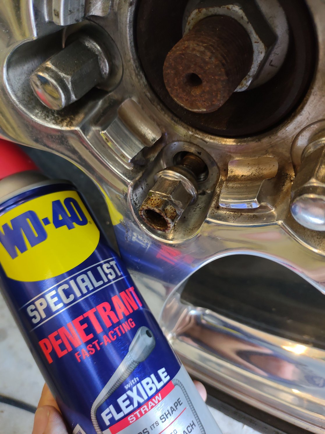

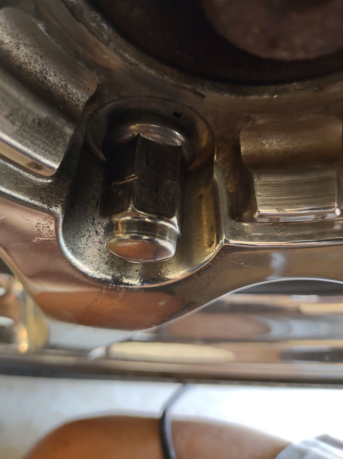

Here is where I am at. I cut away the cover to see what was inside.
Started on one face
Turned it to the next
And so on
Pulled cover off just the end so my socket will still fit.
Sprayed some penetrating oil in there, crossing fingers. Any bets? Odds are not in my favor...😟

Bam!​​ It just turned right off.

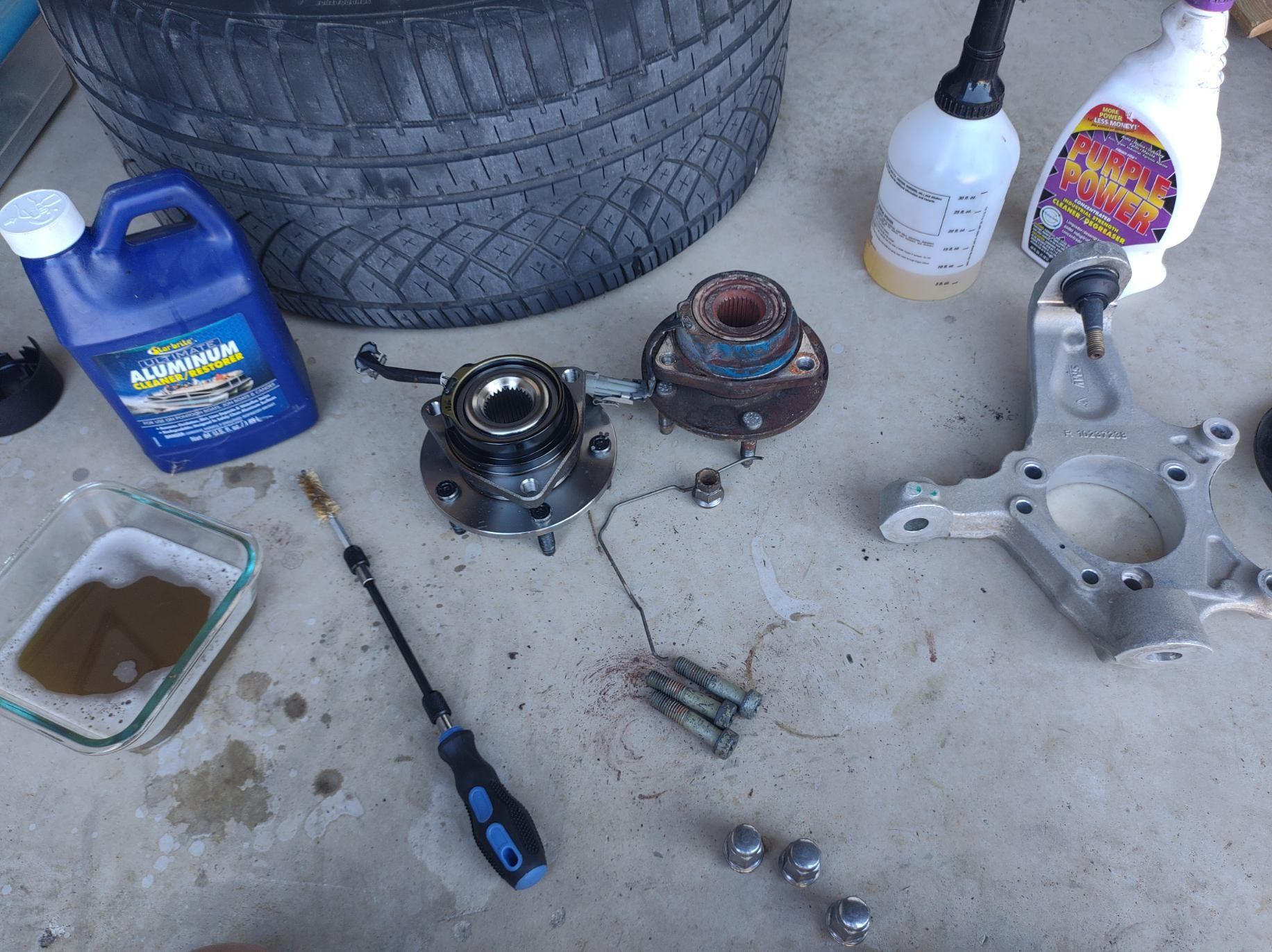

I pulled the hub. Not a bad job at all. I deviated a bit from most of the directions and popped the top ball joint out first by jacking the suspension way up and prying up with a flat bar. Then I was able to pull the knuckle away from the drive shaft and get easy access to the lower ball joint with a wrench and hex key.
I've ordered a Timken hub from Summit and I'm going to swing by tomorrow and pick it up. I hear the showroom there is pretty sweet.

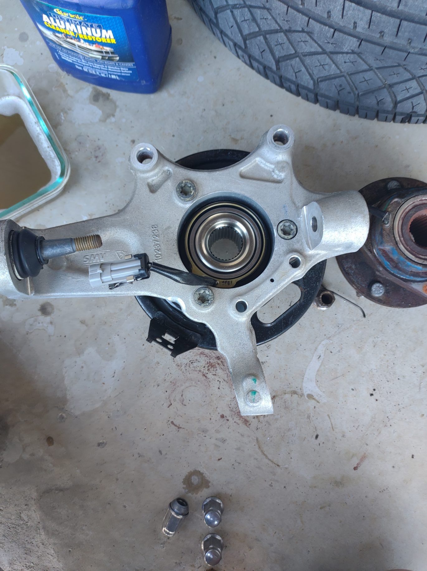

Finished it up, did some cleaning and wrestled it all back together. If you do this, it's handy to have a vice to torque the hub torx bolts down. Before and after....
Take a picture so you know how it goes back together.
These are the cleaners I used on the parts.
Like new!
Honestly the hardest part was getting the brake shoes back on. That spring that holds it on is pretty tricky to put back on.
