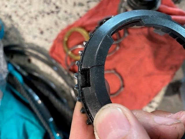

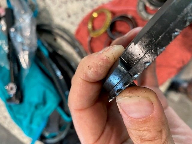

I went through the same thing with my 2004 this year. Changed fluids adjusted the shifter bled the clutch and nothing helped. Decided to pull the rear end and trans and sent both to the shop. Rear end had leaking seal so i had them go through it and put new seals, Trans came apart and what they found was a cracked 2nd gear synchro ring.
I pulled the complete assembly out in my garage, its a task but very doable if you have tools and patience. If you take it to a shop expect to cover 15-18 hours labor plus the cost of rebuilding the transmission.
