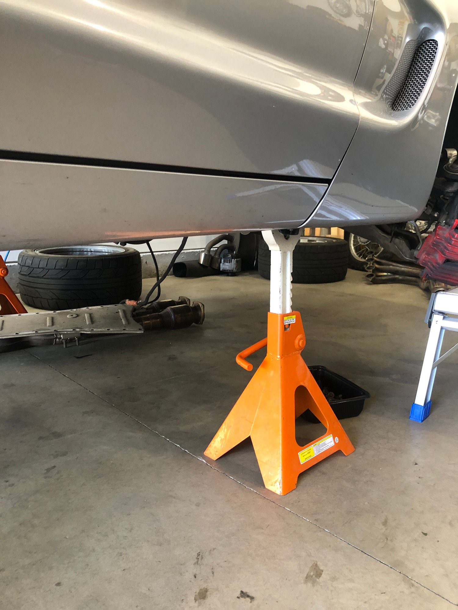

Don’t worry about the mufflers. They can hang in place, use a zip tie to keep the flange end up after you unbolt them, use the zip tie loop hang it to gas tank heat shield bolt that is near by. After you get the rear cradle lowered you can removed the mufflers.
I had my car up about 20.5” on jack stands when I removed the transmission earlier this month.

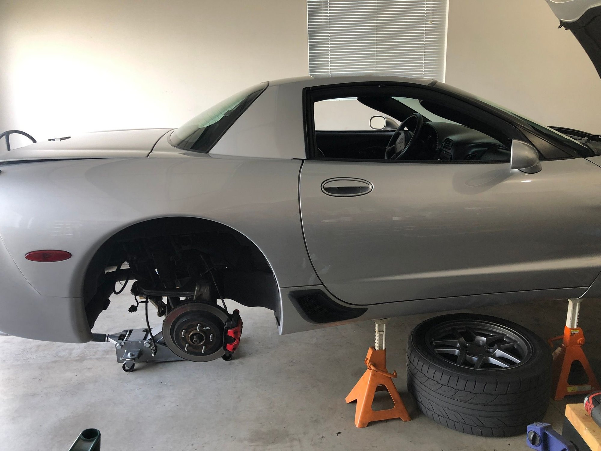

no write up but I did mine on the floor with jack stands, if you have or can get some ramps or big blocks i would leave the front tires on the car and let the tires sit in blocks. This means less weight on jack stands. I also left my wheels under the side of the car when I was crawling around under it. You need the back of the car pretty high for the rear cross member and diff/trans assembly to clear the rear bumper and trunk. 2 floor jacks and 2 people will really make this job easier.

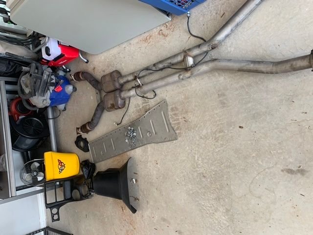

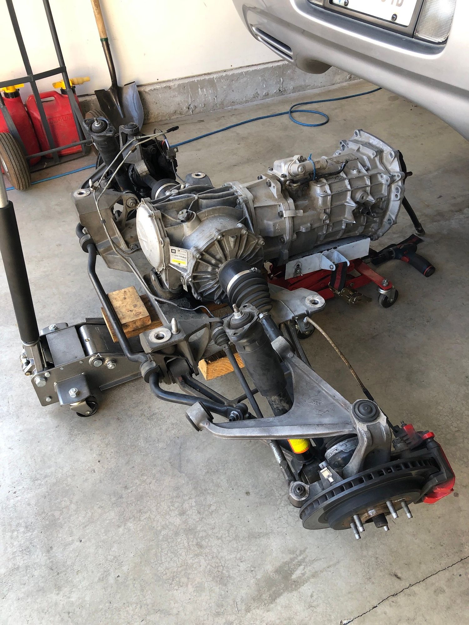

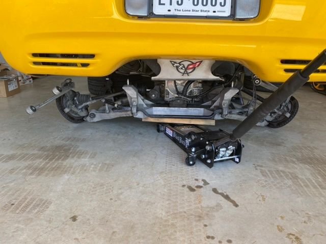

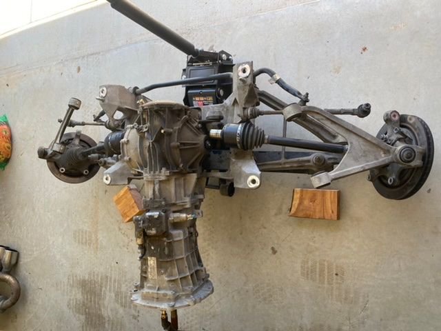

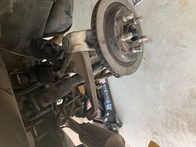

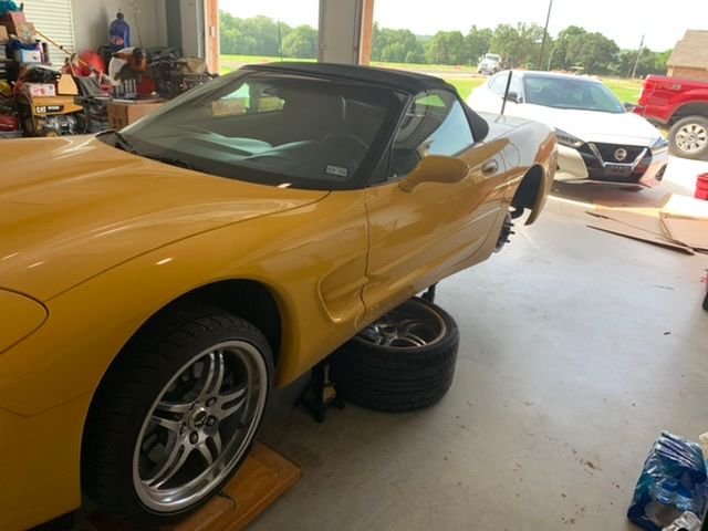

If you decide to do this yourself, make sure to pay close attention to brake line routing and clips. There is also some wiring on top of the trans that needs to be un-clipped and and routed out of the way. A couple of tips to help you out. Take your time, it doesn't look like it but once you remove the clips from the cradle and the axles are out the brake lines will clear the differential. No need to disconnect them. Zip tie the calipers up to keep them out of the way.
your exhaust is pretty straight forward removal but be ready the H pipe is heavy and awkward. Make sure not to damage your 02 sensors and wires, they are clipped into the tunnel.
Remove the upper shock bolts, loosen the lower shock nut and bolt. Remove the upper A arm bolts and put the bolts back in where they came from or bag and tag everything.Once loose the shock can come out easy.
To remove the axle from the differential jack the lower A Arm up so the cv axle is straight, if you try to pull the axle out with a lot of angle it will bind up. The higher the a arm the easier it is to release the little clip. inside the differential.
You will need a long extension to get to the bolts on top of the torque tube, i used a wobble extension or socket to make sure i had good contact.
There are some way better write up on here, much more detail bust giving you some tips here.
Hope it all goes well.
Blocks stacked under front tires
I had to raise the rear end higher to get enough clearance.
Floor jacks are a must
