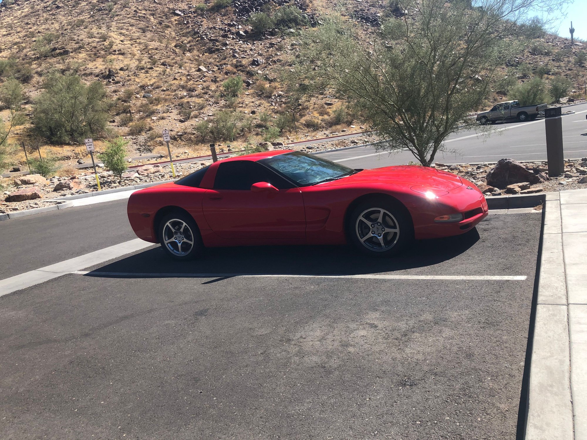

After i got the new cat installed i havnt hit 220 even in stop and go traffic only 1 time today and i was out for about 4h
rs enjoying the car
