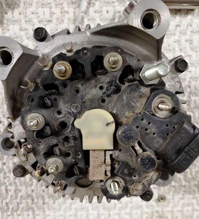

I've got the alternator out and the regulator cover off. I can't seem to get the regulator out after removing the 2 regulator nuts. Is there another nut hiding? I've searched for a good video and/or instructions with no success. Anyone done this or have a link to other help?
Thanks
Thanks
@Ran-D Try contacting @standup triple . He successfully replaced his voltage regulator a week or so ago. Click here to check his thread (he confirmed positive results in Post 23).
