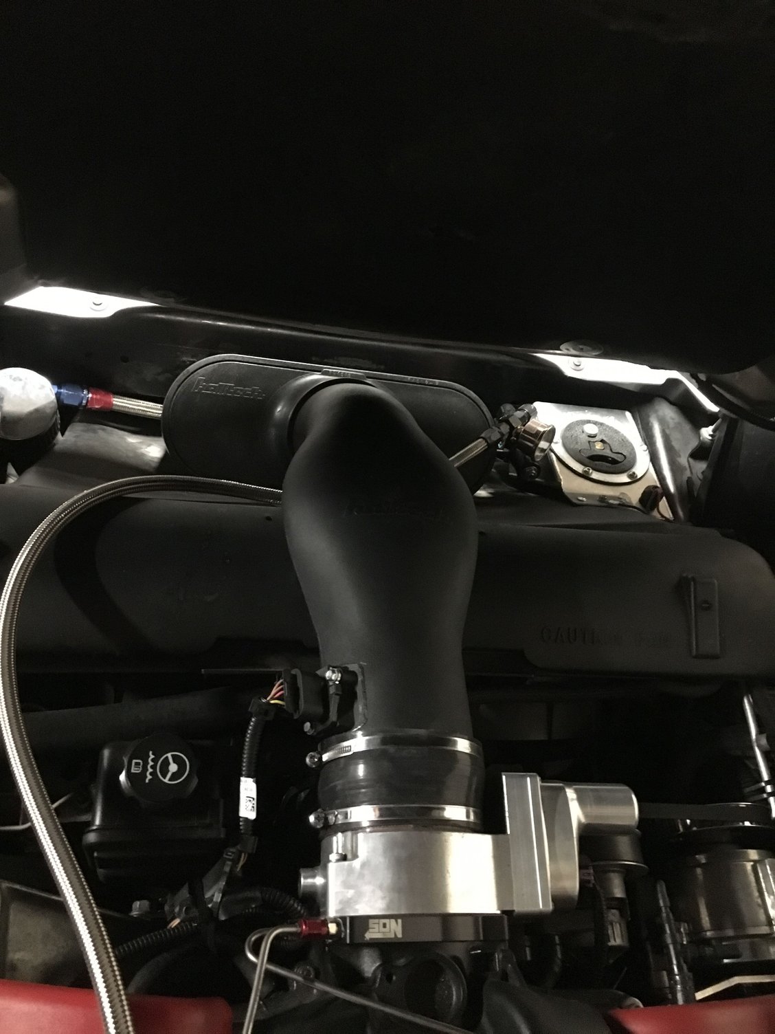

On your water pump- Did you drill the thermostat? Which temperature stat did you go with? Did you get the meziere relay kit?
On you CAI what setup did you go with? I currently have a Blackwing Air intake with factory bridge but looking for recomendations on a new bridge and good flow for the NW102 TB. Thinking of getting the Vararam power duct.

I drilled 1 hole in the thermostat per instructions, I can’t remember what size maybe 1/16 or 1/8, I think I went with either a 180 or 190 temp, I’m pretty sure it came with the relay
I have the Haltech killer bee 2 with ls7 maf

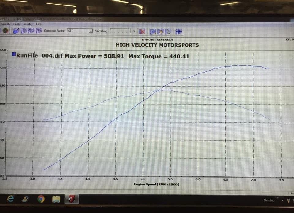

I don’t have a build thread but this is the setup
04z sbe ls6
tfs 215 heads worked over by tea
mamo ported msd
lg pro 1 3/4 headers
lg g5x3 cam
12:1 on 93 octane
ewp
vacuum pump
m12 trans 4.10 gears

Those numbers are great! Have you taken it to the drag strip? If so what did it run?

I used to run 1/8 some but it’s just for Mexico racing now lol but 6.80’s best et and 105mph was best I ever got out of it n/a

Nice, I think that is the highest HP I have seen on a N/A stock cubed LS1/6. How is the drivability?
we were actually shooting for 520 but came up short, the 4.10’s probably gave it a little lower reading but regardless it drives great, drive it all the time, the g5x3 isn’t too radical of a cam
