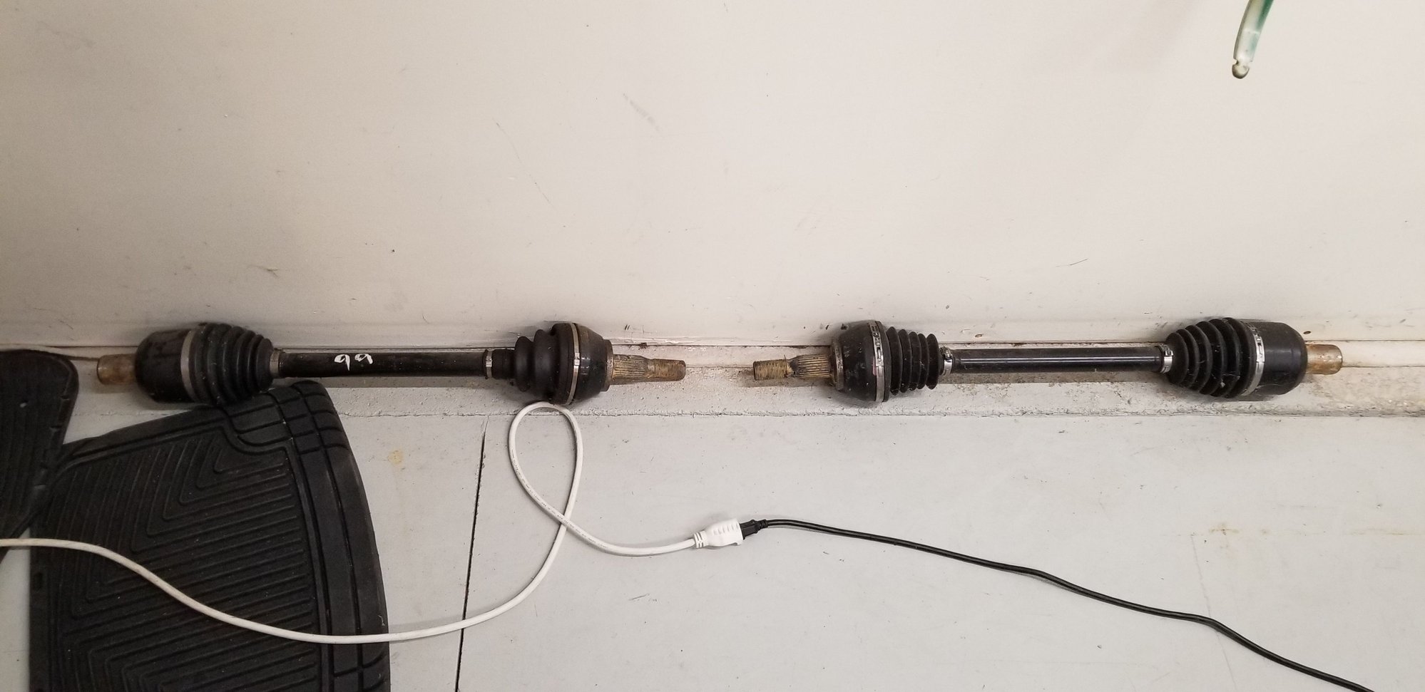

I have pretty much the same setup. I replaced a axle with a factory GM part. I went that direction because the aftermarket axles use really cheap boots that have been known to balloon at speed and take out brake lines.

The one on the left has the cheap boot I mentioned in the above post. The difference is in the ribs. The left one is soft and balloons out at speed

TY Feeder, I understand why they balloon out at speed. Should I replace both at the same time or will I be OK replacing the one with the damaged boot. When I do the job I want my car to be reliable. TY for your help.

If it anit broke, don't bother, other than the occasional leaking boot, I haven't seen to many axle failures without the abuse of hard launches, wheel hop or drag radials
