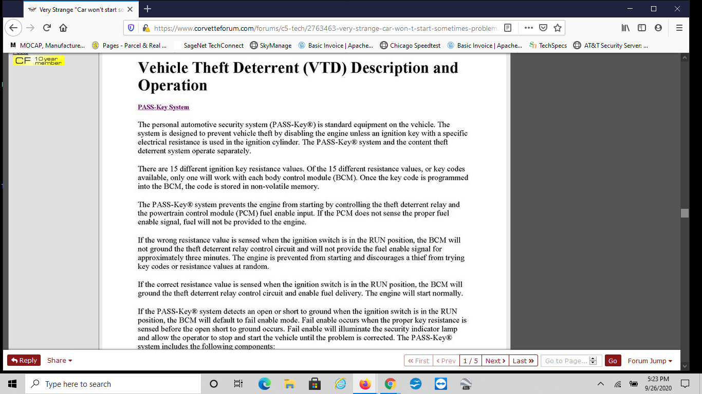

Not really shure ran across this.
How can you not be sure? It literally says if it thinks you're stealing the car it won't let you start the car by not enabling the fuel pump relay. It sounds like based on your current, limited description that your able to start and idle the car but if you move it or load the engine at all it dies. Is that accurate?

From: Espanola New Mexico
I am wondering where that write up came from, on the C5 if the BCM does not receive the correct voltage\current level from the ignition switch contacts that press against the keys resistor pellet the BCM will not provide a ground to the TDR, which is the relay that sends power to energize the starter. If you have a true VATS problem the car will not even crank over, of course the BCM will also not provide an enable to the PCM to turn on the fuel injectors. Most likely you have a problem with the fuel delivery system.

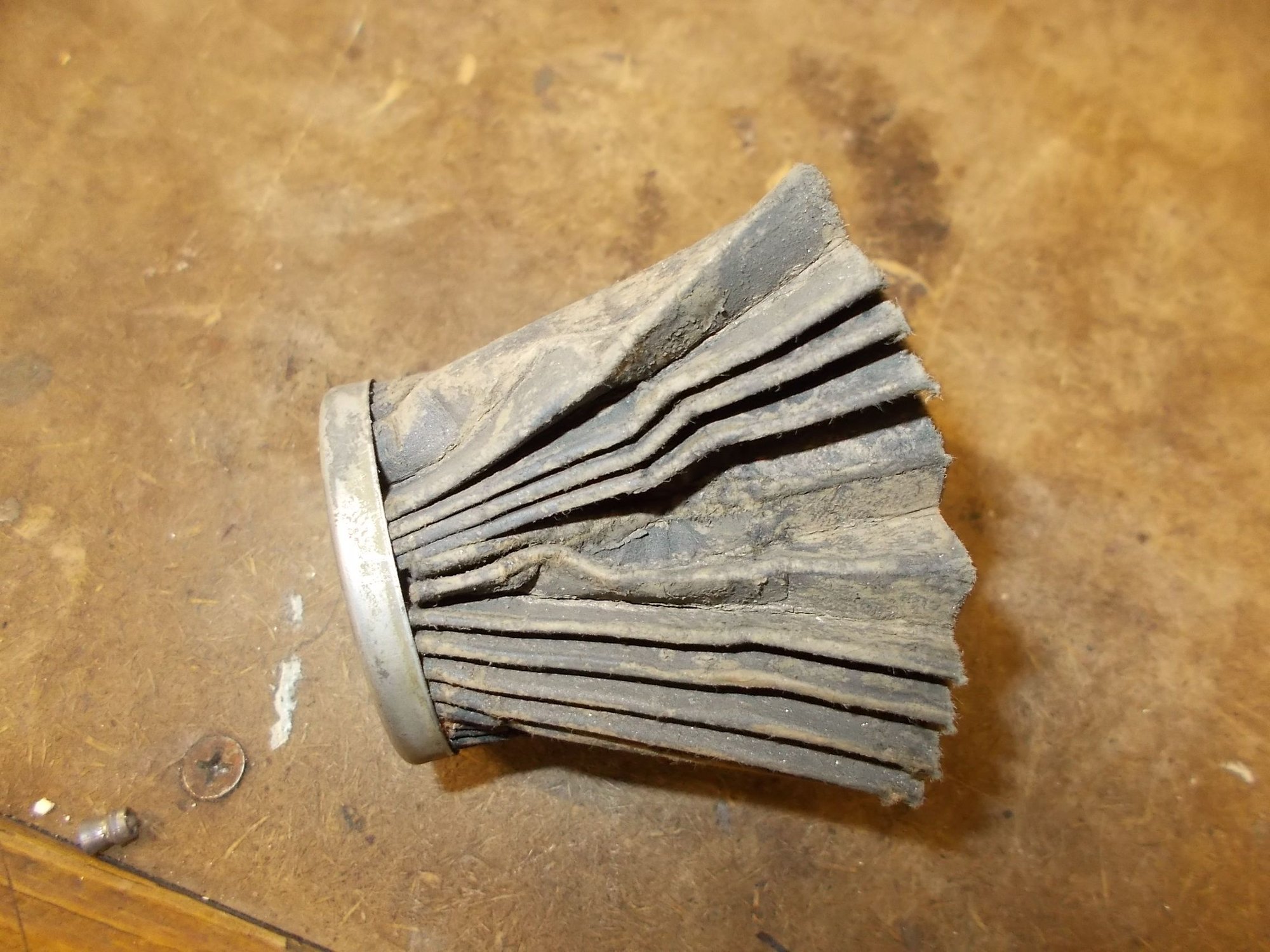

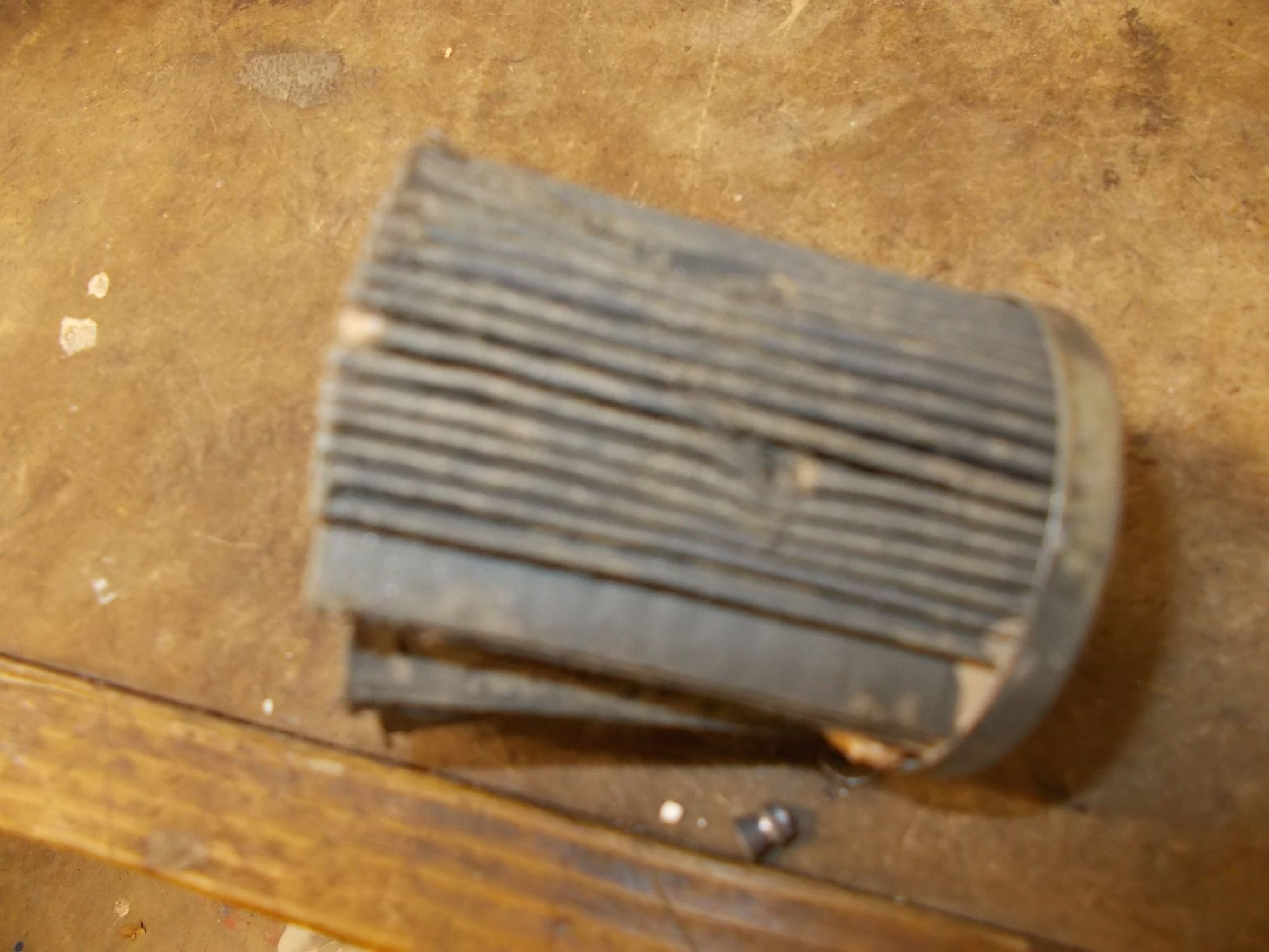

I feel so stupid. Replacing the filter/regulator got it to the desired 50psi. I cut the old filter open and it was clogged really bad. Previous owner threw me a curve. Should I be looking at getting my injectors cleaned or replaced ?
