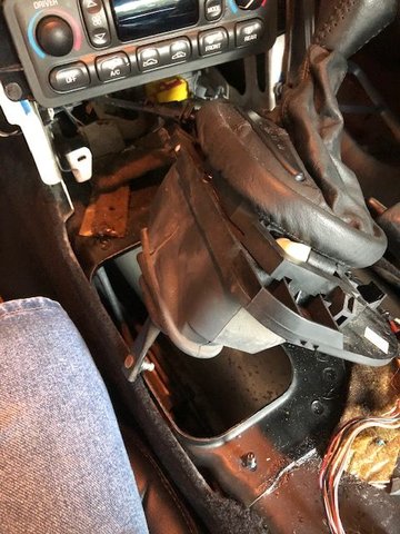

Yep that was the problem thanks! for now i just clicked it back into place but any ideas on how to actually replace said grommet lmao. also idk if this happeneed to anyone else but it seems like the center console wont go all the way back in its stuck on the shifter it looks like but ive got no clue and im really frustrated
You can buy replacement grommets at Advanced Auto. Be careful putting it in. If you stress the cable too much you will break the plastic housing and then you will need a new cable. I know that from experience.
