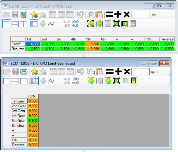

You should be able to do this with stock PCM. There's separate tables for fuel cut limiter and electronic throttle limiter. Stock Z06 file uses fuel cut in all gears except 5th, where its ETC limited. I've never tested this myself....but in theory you could set the ETC table to 6000 and fuel cut table to 6500 or something. But I don't know if this would give you the desired effect either. Worth a shot.
If you know someone with a HPT cable, it's only $100 to license the car.
