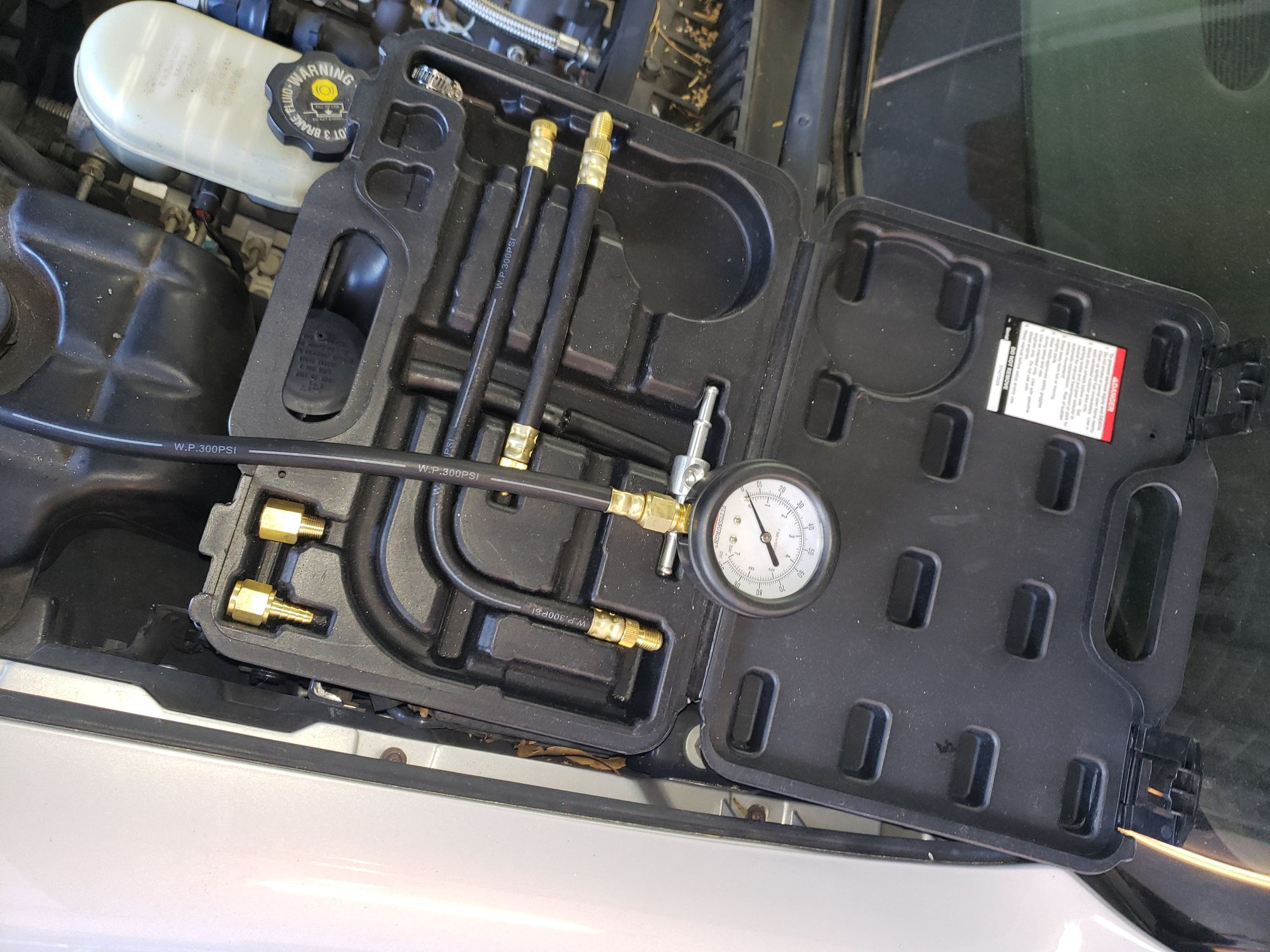

FINALLY had some time last week to try and figure this out.
I bought a fuel pressure gauge (Harbor Freight). Shows ZERO PSI with key in "ON" or when cranking.
I can hear the pump prime.
I thought maybe bad gas, but after checking pressure several times, when I remove the gauge the gas looks clean and does not smell bad like it did when Bill Curlee had me see if fuel would come out at the schrader on the rail.
Definitely getting spark.
Changed the filter, still no start or pressure.
When I bleed off the fuel in the rail and try to start is when it fires for a second then dies.

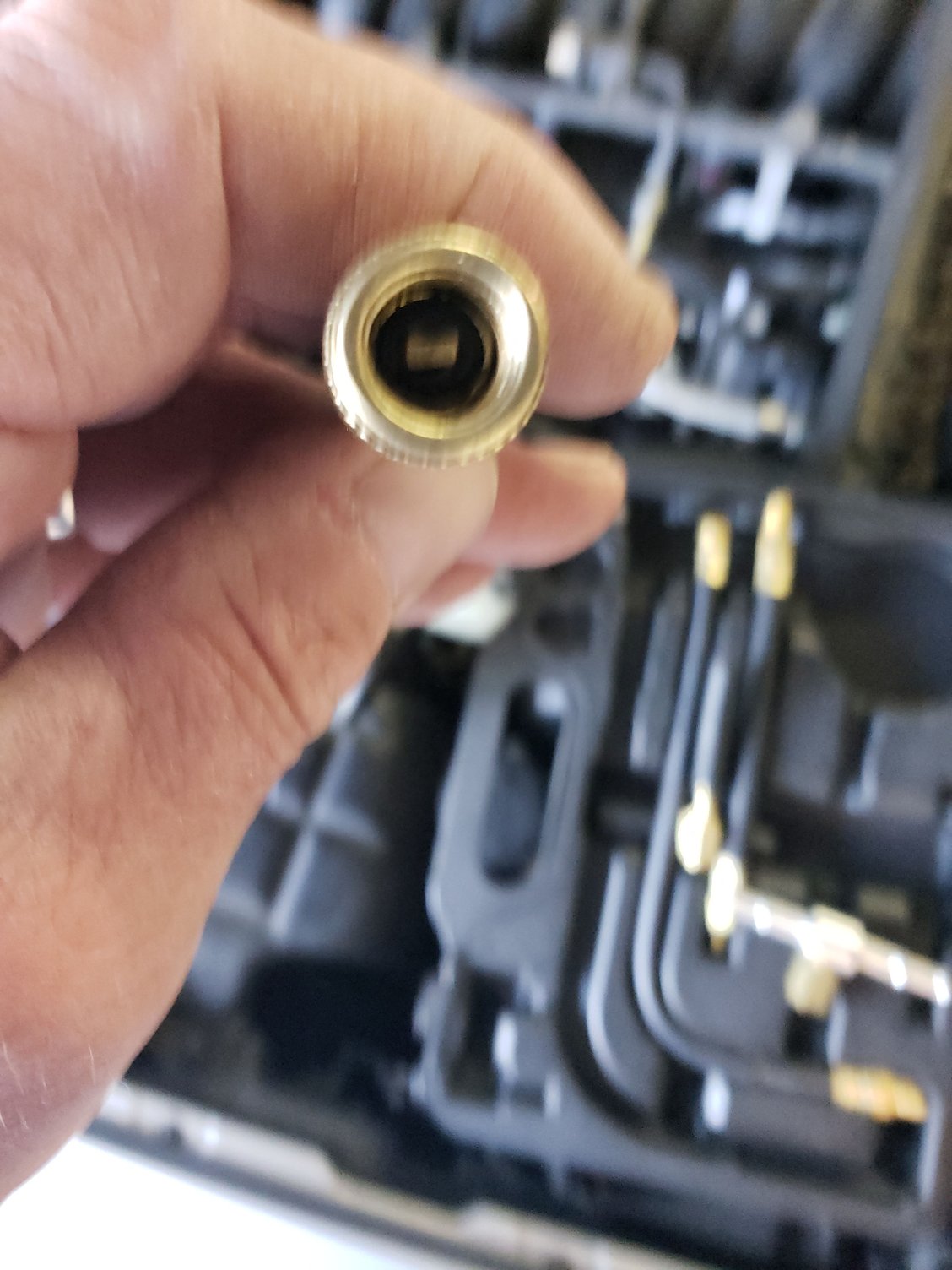

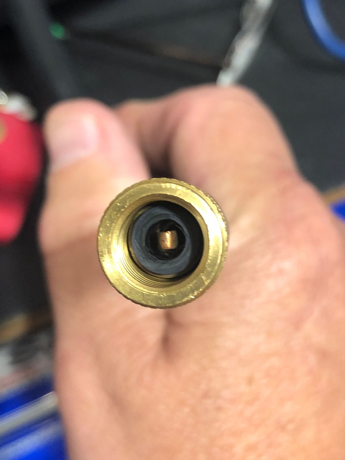

Does the end of your HF fuel pressure gauge look this this ???...if you don’t have this little pin in the center of the hose it won’t unseat the schrader valve on the fuel rail and you won’t read any fuel pressure !!

Yes it does. I have to tighten it with pliers or it leaks at the schrader
