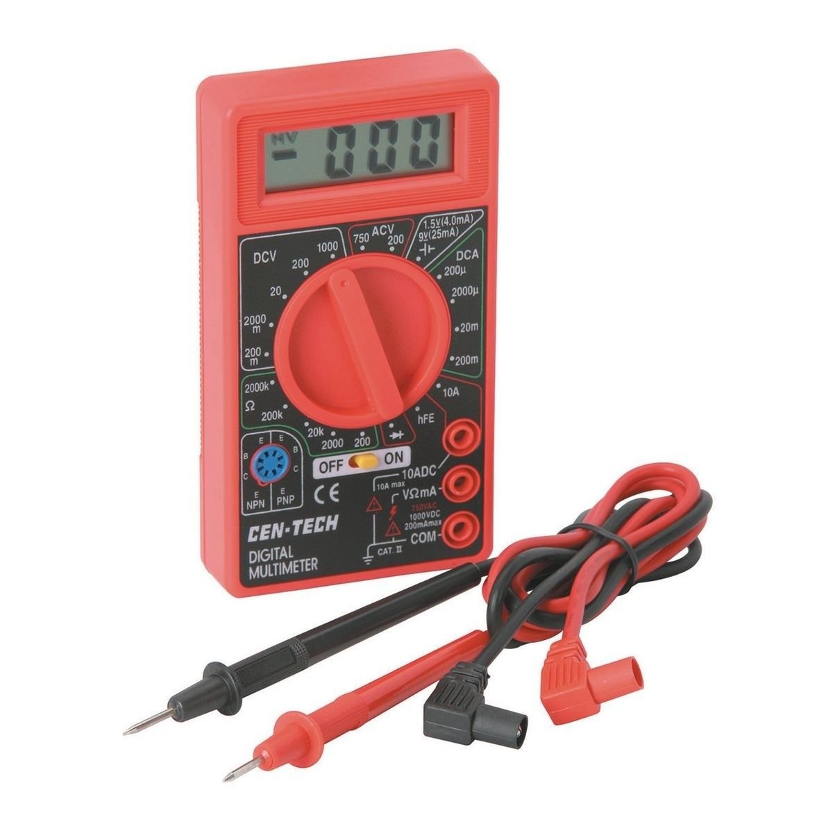

I ask this, because I picked up a cheap little $6.00 multimeter at harbor freight to do this. I just want to make sure it will work. This is the one I got
10ADC plug > DCV setting > 200m setting?
Does it matter which sides of the fuse I am testing. Is one side meant for the hot and one side meant for cold?
Thanks again and sorry for the dumb questions. I hate to have to ask you all of this, but I just want to make sure I do everything right. You guys are awsome, thank you for all of your help.

Since you don't know how much current you will be reading I would use the 10ADC connector (top one). The 200mA setting requires use of the 200mA connector (middle one) which has a max current of 200mA. Using The 10ADC connector means you will not have a range setting. You must use the Red dot 10A setting. But you should be able to read large mA currents since this meter seems to have 3 digits.
I prefer to run the multimeter in series with the battery to measure current. Unless you have an inductive meter (really cool btw). I don't know about any of your other questions.

Originally Posted by Mike's2001-Z06
Do not use that meter to measure/diagnose resistance. We actually buy those to show students in class how inaccurate they are with resistance. Usually they are decent for testing voltage but this is more of a meter you keep to check the trailer wiring, not critical electronic checks.
