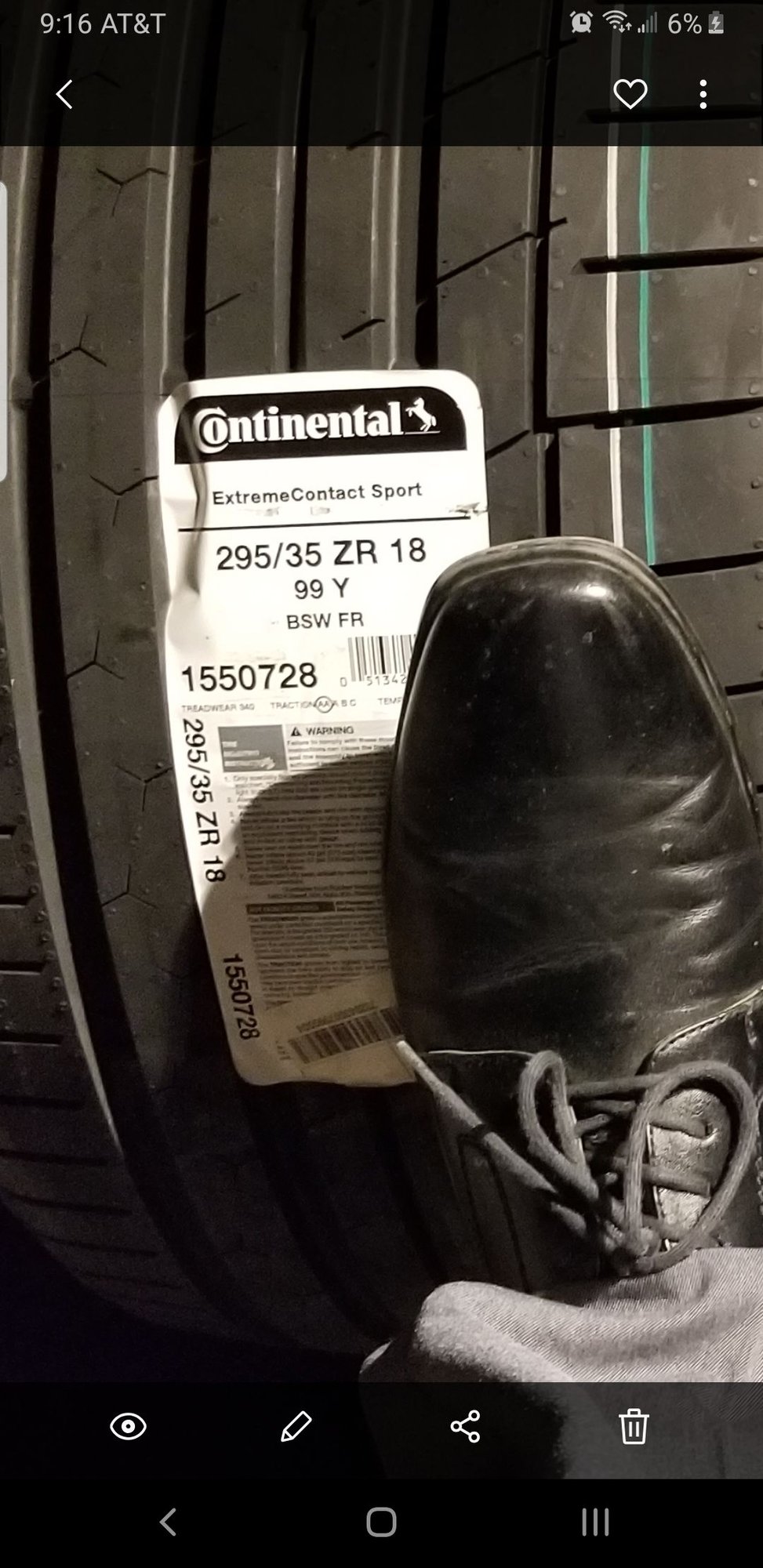

I bought a set of Continental Extreme Contact Sports on Z06 wheels. They have been excellent so far. Very grippy, predictable, low noise.

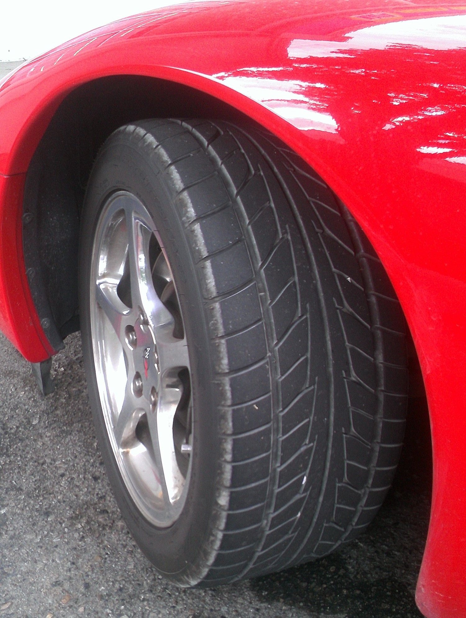

I have been running Nitto 550s on my 03 Vert. Will buy them again.
