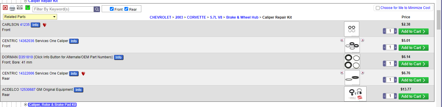

I put in the DRM pistons and rebuilt the fronts and rears back in 2016. Had never done it before, but turned out to be really easy and straight forward. I thought removing the pistons was going to be some big ordeal...but you just need a little compressed air, super simple.
Honestly the worst part was getting all the air out of the calipers once reinstalled on the car. But you're going to be doing that regardless. I have a motive power bleeder which helps quite a bit I think.
Rebuild kit is about $11-12... I used the Centric kit.
The centric pistons are about $10 a pop.
In my case I ended up just putting in the DRM pistons up front, and reusing rear pistons--just new seals etc.
