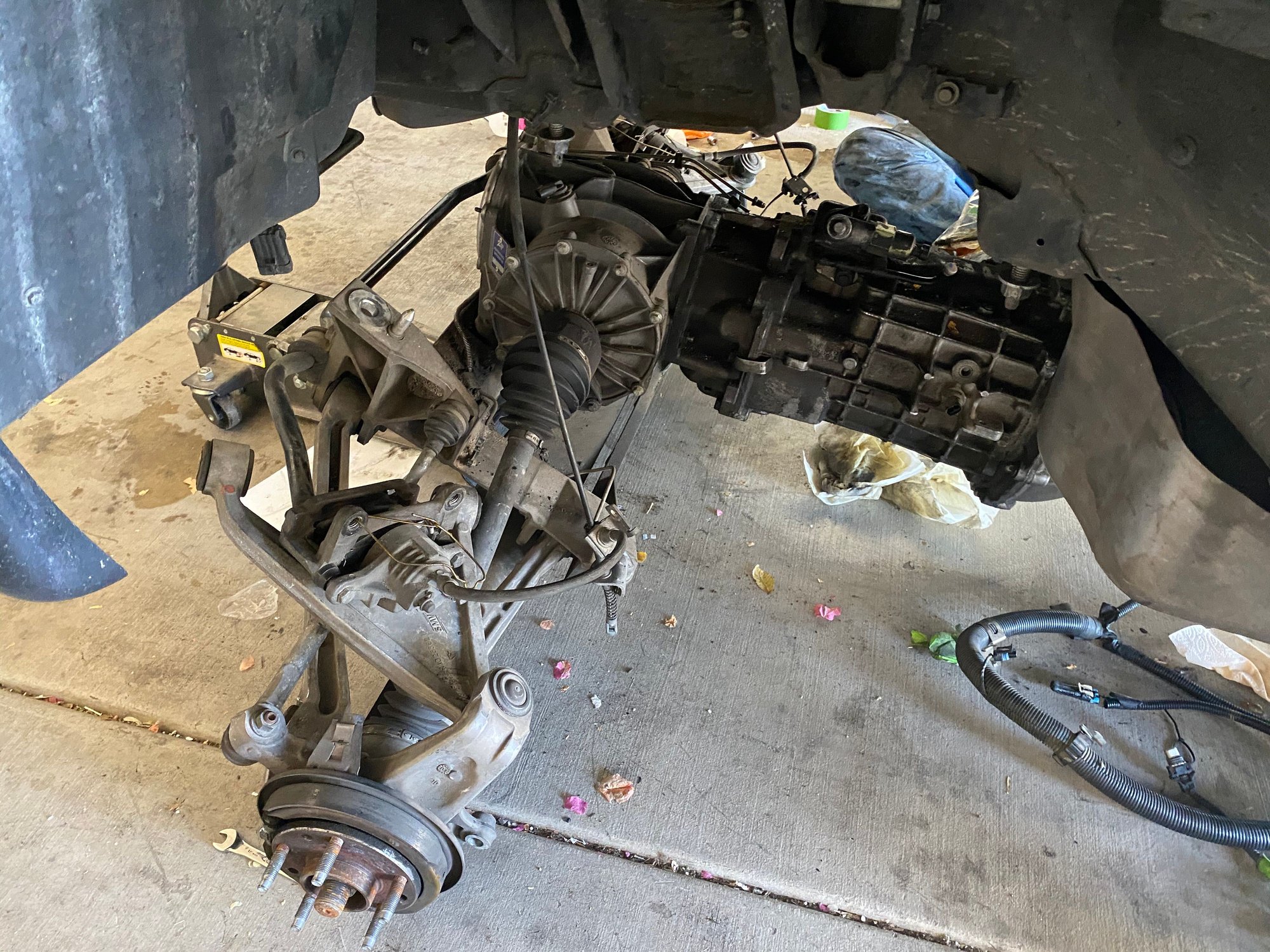

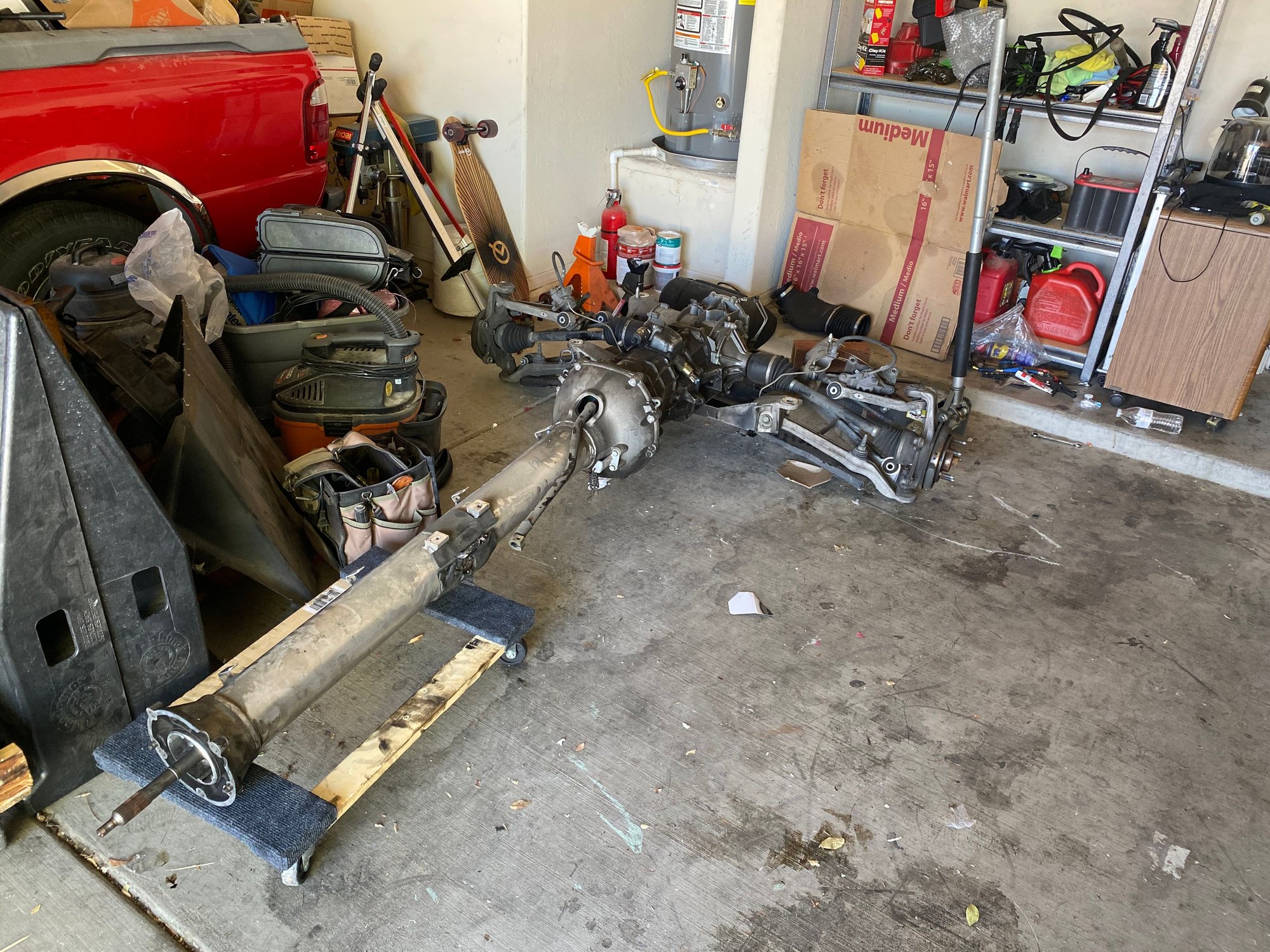

For me at least, pulling out the whole TT/trans/diff/rear end assembly wasn't really a challenge. But putting it all back together I definitely preferred putting in the TT, then the trans (including situating the shift linkage), then the diff, then the rear end.
