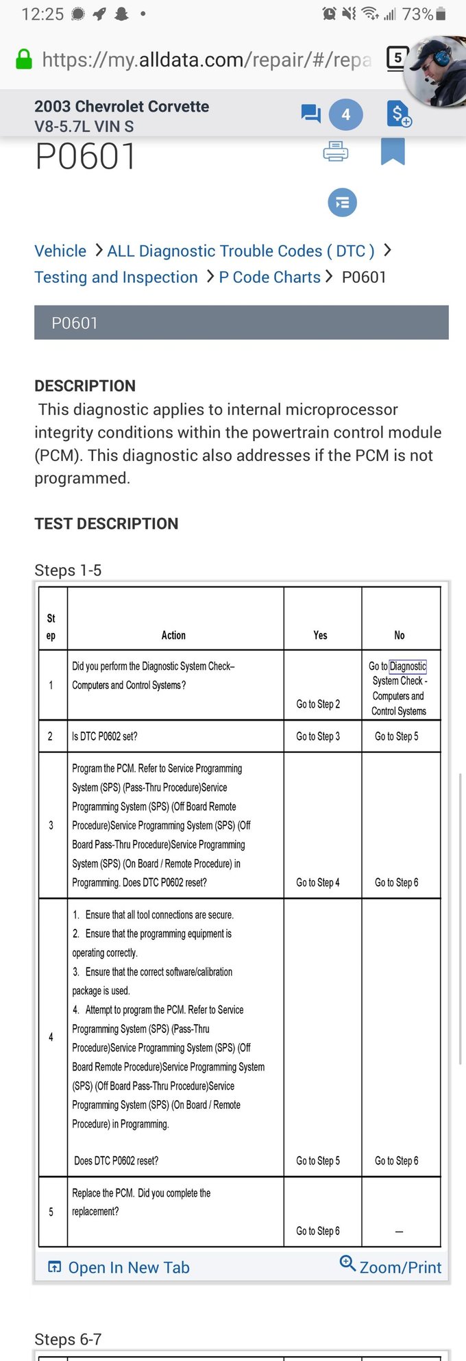

Checked fuse. It is good. Putting the battery on the charger to make sure it is good next. I did get other codes to come up now:
p0601
p1518
B2723
U1096
U1160
U1016
B2284
B2282
B2283
B2285
U1096
U1064
U1016
B2172

P0601 HC
p1518 HC
All the rest were just H

OK I think this 0601 is your actual problem. I'm not sure what this really means beyond something isn't right in the PCM. Sounds like it could be a hardware failure of some kind but that's not very common.
