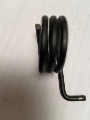

I have a 2003 Standard Shift Convertible. I found this broken spring below my brake & clutch pedals but I can't figure out what it was attached to before it broke..
I looked under the dash and there was a similar spring (not broken) attached to my clutch pedal, but nothing attached to my brake pedal.
There doesn't appear to be any place for a spring to be attached to the brake pedal --- so where did this broken spring come from. Does the clutch pedal have 2 springs?
Both pedals (Clutch & Brake) seem to feel and work fine.
Anybody know where this spring came from so I can order a new spring and replace it?
Thanks

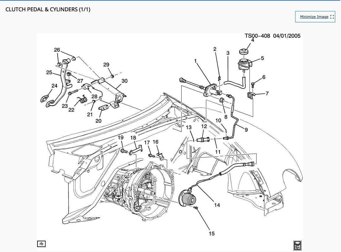

Looks like the clutch pedal over-center spring. Mine was half-broken too. FYI your clutch pedal feel will be heavier without that spring fully intact.
https://www.camhughes.com/2012/03/re...return-spring/
You can see where it goes on the full pedal assembly:
https://www.ebay.com/itm/Corvette-C5...YAAMXQl6pRX13F

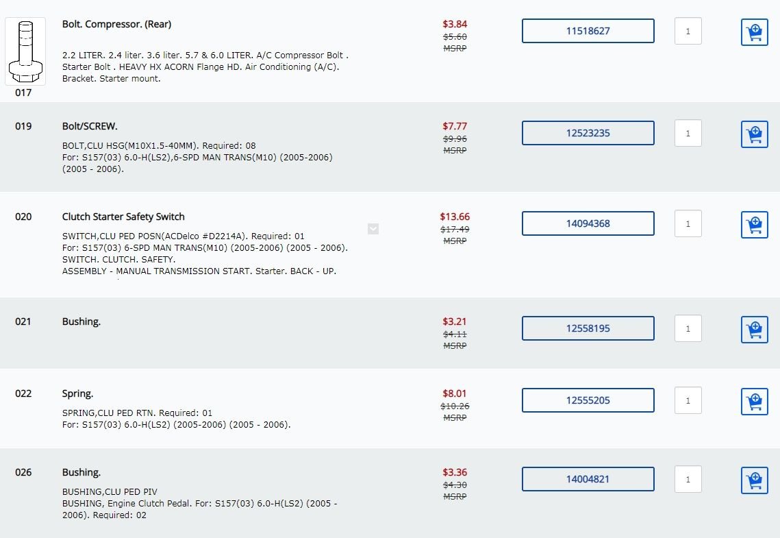

The GM P/N is GM 12555205.
https://www.cultragfactoryparts.com/...pring-12555205

OK I see this is a double spring where half of mine is broken.
Will order new spring ASAP
Thank you for you fast reply and GM part number

Here is a breakout of the whole business in case somebody needs it . I just need part 22
