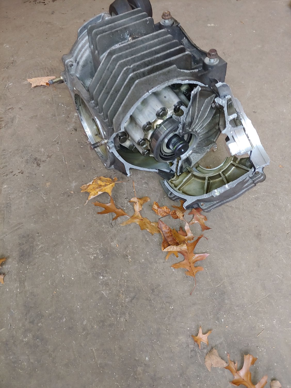

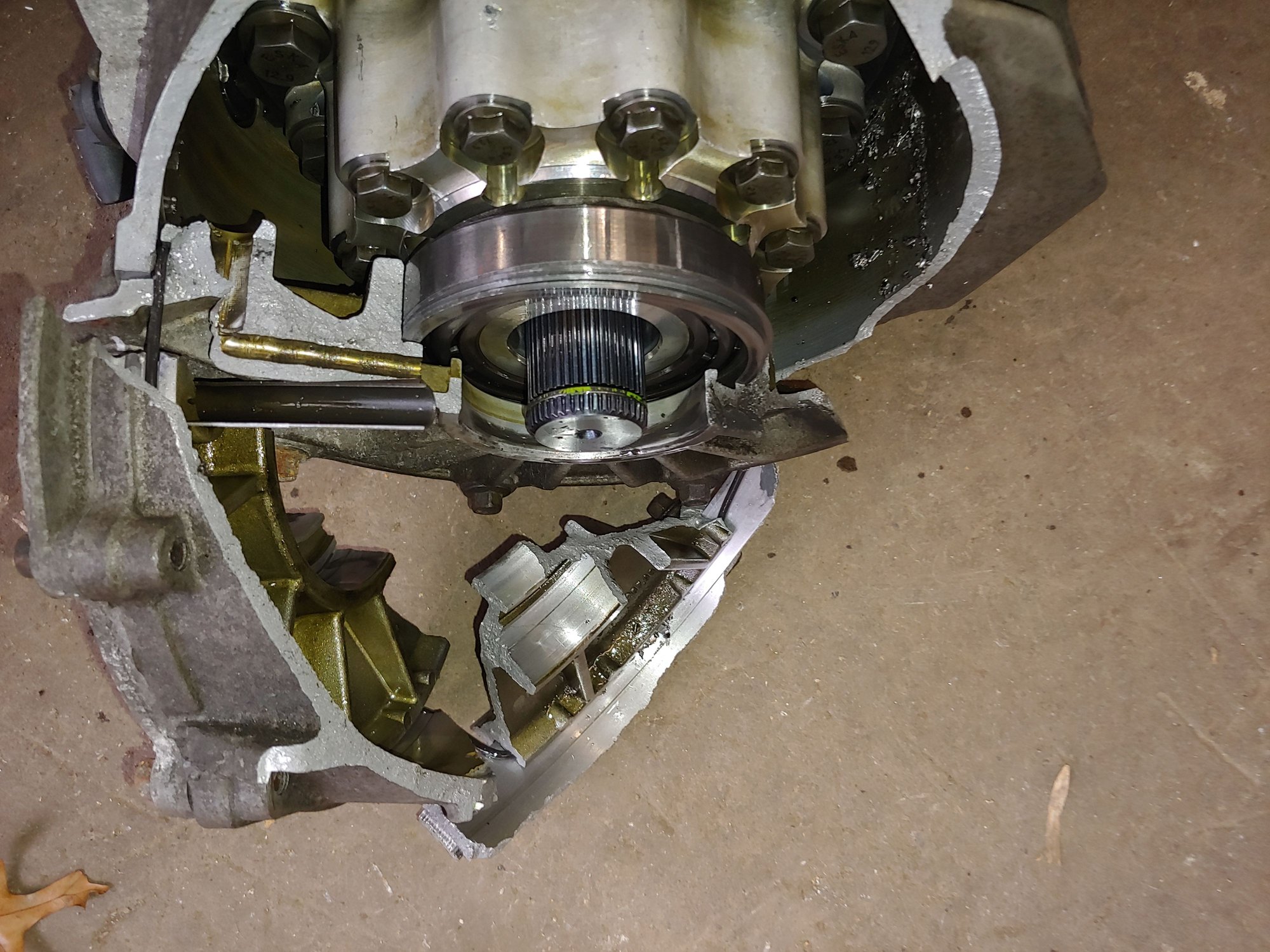

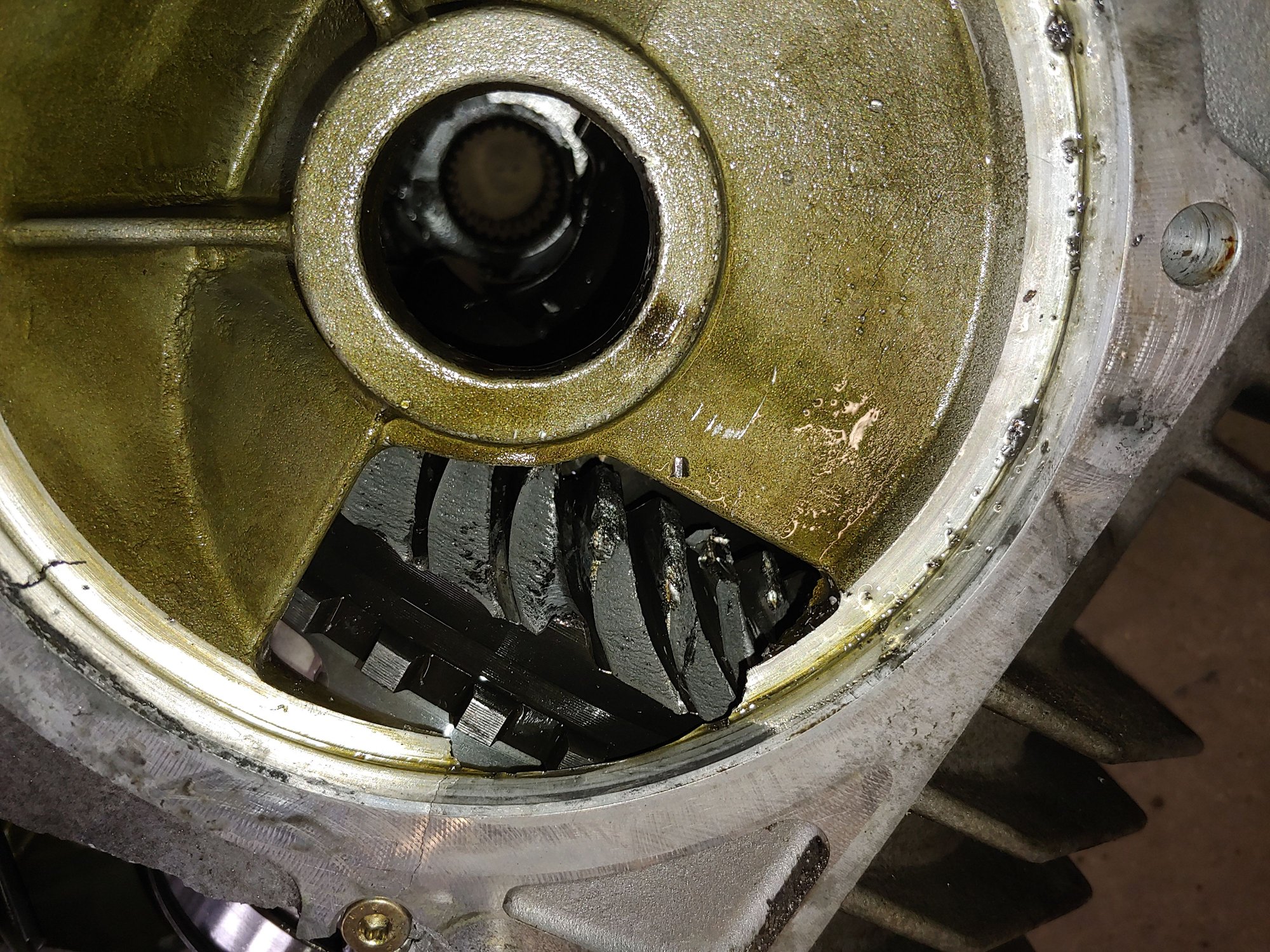

I havent fully opened it yet, but it was total carnage. The whole passenger side casing cover shattered and broke into three large pieces and a thousand small pieces. The ring gear was also inialated. Thinking the gear itself broke causing a chain reaction. I have pics I will try to post up later this AM or IM you. Haven't posted a pic on here in a decade.

Old Oct 27, 2020 | 10:47 AM

Holy mackerel you smoked that thing!!!
