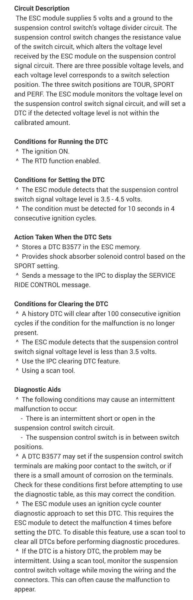

This might help. Sounds like either there is a bad connection inside or outside or the switch broke. I have a Z06 so the switch isn't in my car to know, but you may be able to disconnect the switch and take it apart. If it looks spooky maybe you can fix it instead of buy a new one.
Try testing the circuit with a voltmeter and see what voltage comes out of it when the switch is in the various positions and report back before you buy parts.
