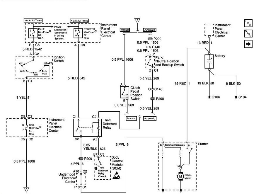

You are going to to have to do some meter testing at the Theft Deterrent relay in the passengers foot well. Its on the fire wall above the BCM. Thats the HEART of the entire starting system. It has four wires RED, PURPLE yellow and yellow black stripe. The RED id battery buss constant 12 VDC power, the purple is the starter solenoid hot wire
The Yellow is HOT when you crank the engine. The yellow / black stripe is a BCM ground. The BCM grounds that wire when its happy with the cars security.
If you turn the key to crank and pump the clutch peddle on and off the clutch switch, you should hear that relay clicking on and off. Below is the schematic. Check the fuses in the circuits.
So I just tried pumping the clutch with the key in crank position and I do hear clicking.
