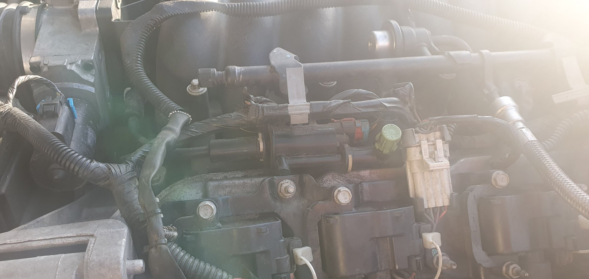

Hello All,
I'm working my way through my dirty beaten up 2002 Z06 as my first project car. Previous owner(s) were not gentle with her but did end up putting on AFR 205 heads as well as some other mods.
I came across this disconnected hose (see 1st pic) coming off the driver side valve cover near the rear of the engine bay that's just been cut and left unattended. I did some research and found it is a PCV system hose. I thought on the LS6 the PCV hose connected the intake manifold to the valley cover (see 2nd pic). Should this driver side valve cover nipple and hose even be here though? Maybe it has to do with the aftermarket heads? Should I just cap off the driver side valve cover nipple?
(Yes, she is very dirty, my apologies. She is far from show car ready but we have to walk before we can run...)
Many thanks in advance!!!!

It might be the air injection hose connected to a one way valve located behind the head which injects air into the exhaust manifold at start up.

that snake-shaped-ribbed hose is the connection from the fuel tank to the purge valve. When the engine is running, the purge valve is cycled to pull fuel vapors from the charcoal canister. Part of the emissions system, and you probably have several P044X codes. So if you are in an emissions monitoring locale, you won’t pass inspection. Your picture on the driver’s side doesn’t show the purge solenoid, but with that hose off your fuel trims are going to be all messed up, as that will be un-metered air going into the engine when the pcm commands the purge solenoid to open. Fix that and your car will run better. I will bet you may have lean codes, and misfires too. I would replace the purge solenoid and that hose, clear the codes, and then run a DRIVE CYCLE (a specific drive cycle specified by GM and you can find on the internet). Then pull the codes on the DIC to see if any came back. You will need a scan tool to check readiness monitors, but if you don’t get a check engine light and no codes after a drive cycle, you will have the engine running as good as it can be, given its overall basic health Those gray rings are the hose locks. They are actually “C” shaped, and will release if you push IN at the center of the “C”. They are easy to break, hard to find replacements.
The passenger side looks OK, the curved pigtail hose properly connects the valley cover to the throttle body (TB), and the other hose goes from the valve cover to the TB as well. Now, if the PCV orifice box is cracked under the valley cover, your PCV will pull too much vacuum. If you get the engine good and warm and crank up the rpms, say in second gear, then back off the throttle. If you get oil smoke out of the tail pipe, you are either getting a lot of piston ring blow-by, or the valley cover needs replacing. If the intake runners are oily, you may need a catch can to cut down on the oil sucked out of that hose from the valve cover to the TB.

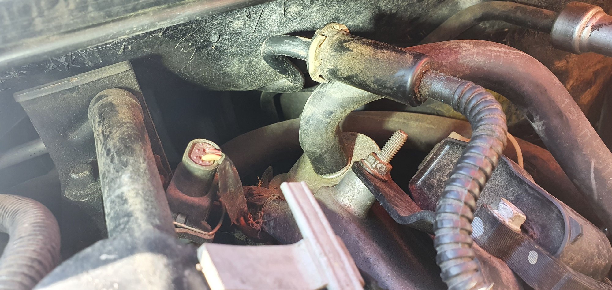

Hello, thanks for your reply! I believe that the snake-shaped-ribbed hose is plugged in correctly? Pic below.
I should've mentioned that the car has an AIR/EGR system delete. It throws code P0412, which I think is for the unplugged connector/vacuum lines to the removed AIR pump. I believe the code should've been tuned out but who knows....
So at the end of the day, should I just cap the AIR hose that is disconnected? I thought the LS6 did not have the AIR hose here.

yes that end, going back to the charcoal canister looks ok. Is the other end open? Can’t really tell in your picture.
So what DTC”s do you have? RESET any messages on the DIC such as “door ajar”. Now Hold down the OPTIONS button, while holding, press FUEL 4 times. Release both buttons. If you press OPTIONS once, you will go into manual mode where you can scroll one module at a time. Pressing OPTIONS again will advance to the next module. Right now all you care about are the PCM Codes.

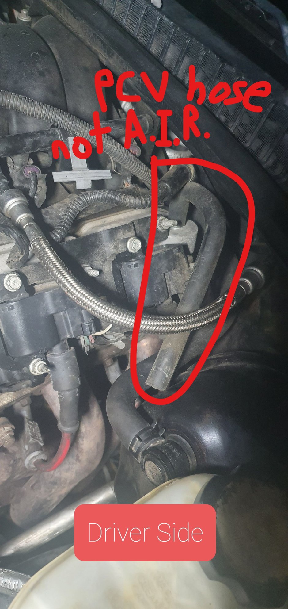

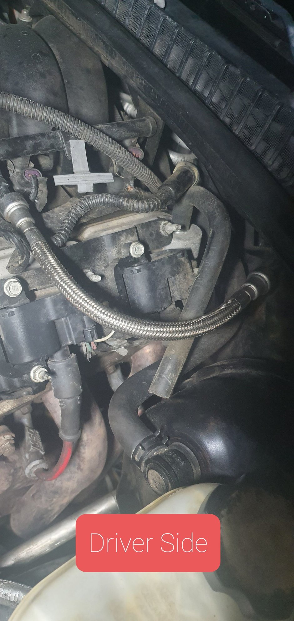

The thread was originally regarding the disconnected PCV hose in the pic below. I was asking why this hose was here and if I can just cap it.

That hose is not normal. When you have the U shaped pigtail hose at the TB to valley cover, There should be a plug in that hole in the driver side rocker cover. when you have that pigtail.That hose, if is is venting is letting crankcase vapor into the atmosphere. So, your PCV system won’t recirculate gases. The crankcases on cars used to be vented to atmosphere, so really, the main problem you may have is smoke coming out of that hose when you run the engine, and unwanted crap sucked into the crankcase should the PCV orifice box inside the valley be broken. That will then pull unmetered air into the engine, and that dangling hose a good path. Stick a cork in the open end and see what happens.
I think you are going to find a lot of oil in the intake plenum. This by itself will hammer good performance, making the engine burn oil along with the gas. Doesn’t take much oil to affect performance.
Do you know anything about your tune? usually when people do cam and heads, a speed-density tune is applied. That will keep the overall engine a little on the rich side, and sometimes a lot richer. Over time that rich condition along with oil ingestion will foul plugs and carbon up piston tops. Usually, the port fuel injection keeps these engines clean,so if you have a bore scope,scoping thru a couple spark plug holes might give you some clues.
There are a lot of mods and sorting them out to get a great running car is often tough, as you may be trying to fix the mistakes of others.
