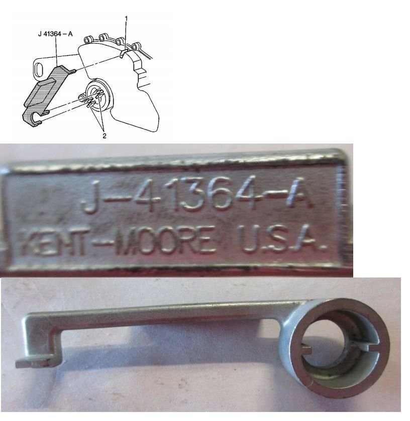

OK let get you a fix. you are on the right track in troubleshooting this P0705 Code.
Please advise if you rigged or aligned the switch before installing the switch to the trans, see below.?
When removing the switch, for replacement, that Trans should be in NEUTRAL.
J 41364-A Park/Neutral Position Switch Alignment Tool
Install the J 41364-A to the park/neutral position switch.
1.1. Align the two lower slots on the switch (2) with the two lower tabs on the J 41364-A .
1.2. Rotate the tool until the upper pin on the tool is lined up with the slot on the top of the switch (1).
2. Check that the transmission is still in NEUTRAL
Important: Do not remove the J 41364-A from the park/neutral position switch until instructed.
3. Install the park/neutral position switch to the transmission manual shaft.
4. Install the park/neutral position switch mounting bolts.
5. Remove the J 41364-A from the switch.
FYI, the tool is available on FleaBay,,,
Post up your findingd/fix.
